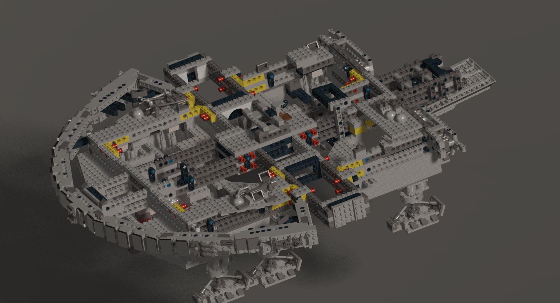

Thanks, it works, pro/e made nice html page with all infos.
Now I am making Millennium Falcon, I am somewhere in the quarter of model building, but the count of bricks is same as y-wing:
