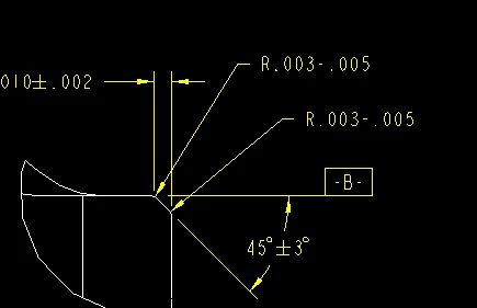

Folks,
I'm trying to show a dimension with its tolerance limits and I can't figure out how to get the max and min values to sit on top of one another. See below. I want the "R.003-.005" to show up as "R .005.003" with the max shown over the min. Is there a config option or something somewhere that lets me do this??? I am using Creo 1.0
Tim
[cid:image001.png@01CD761A.7DCAC380]

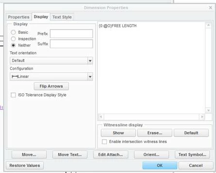

To get this back to dimensions stacked on top of each other Right Mouse click the dimension and go to the properties and select the Display tab and click the "ISO Tolerance Display Style" option.
Mike
[cid:image002.jpg@01CD762D.5A1BF540]
tgiauque1-VisitorAuthor
August 9, 2012
Lots of good replies but this one was the one that worked. A couple of people pointed me to the "ISO Tolerance Display Style" checkbox on the screen shown below. That did the trick! I'm not sure why this wouldn't be the default option for the "Limits" display mode, especially since "R.003-.005" means something very different to me than what the design intent of the dimension was, but whatever.
