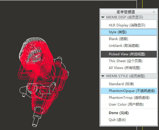

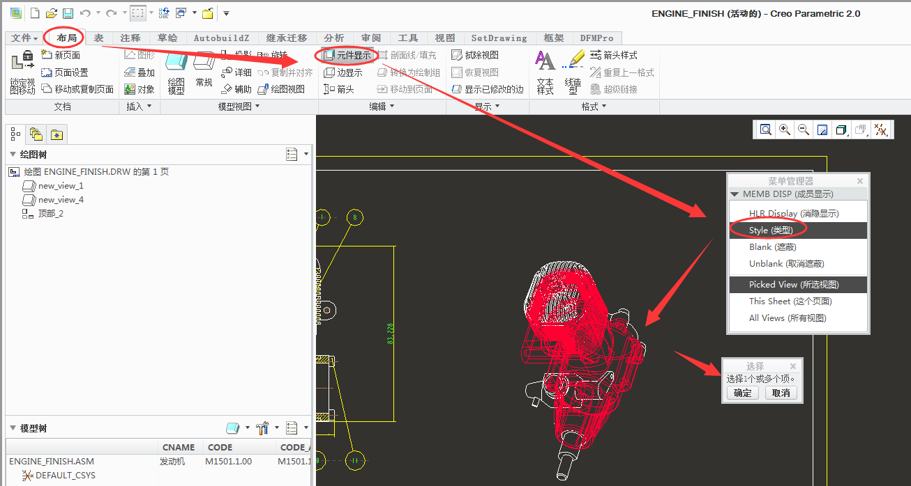

to select all assembly components easily you can use Search tool search.png.
MH
October 26, 2016
MH
October 26, 2016
    You can be executed as shown in picture
