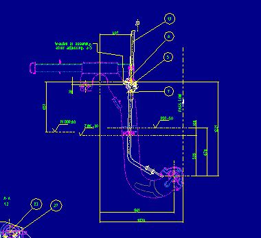

How do you change the linestyles of certain views within a drawing in Creo 2.0? As you can see in the image, one piece of the equipment is shown in a phantom linestyle and another piece attached is shown as normally viewed. See below.

You can change the linestyle of certain components within a view, multiple view, or all views.
  1. In the layout tab of a drawing, select "Component Display".
  2. In the menu select "Style" and what views you want (current view, etc.).
  3. Select the components you want to change.
  4. Hit OK or MMB.
  5. Select the linestyle you want.
  6. Hit Done.

Thanks Eric for the response. I went through your procedure and that worked. Thanks again!
