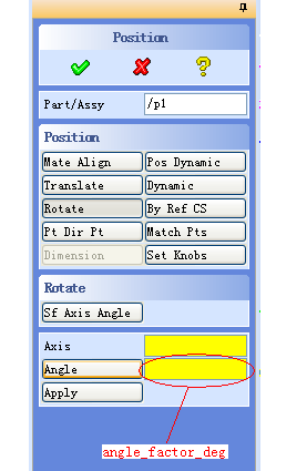

I programed a LISP for a blank to roll one angle 0.9° step by step.( see the attachment LISP file)
Because position_pa command is a terminate action,so I use sd-call-cmds function in the LISP program.
When I ran the program to roll the part 0.9°,actually rolled angle was 51.566202°.
Does anybody could tell me why?
How can I  achieve my purpose to roll 0.9° step by step?

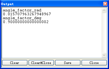

I know that 0.9rad equal 51.566202degree.
In the LISP using position_pa action have to set the angle in degree. So I set a variable angle_factor_deg.
Ran the LISP,you could see variable angle_factor_deg value was 0.9.
Justin

A couple of tips  These will replace some of the work you did.
(sd-deg-to-rad angle)
(sd-rad-to-deg angle)
Lisp works in radians despite what units you have set.
So simply change the line from
:rotation_angle angle_factor_deg
to
:rotation_angle angle_factor_rad
regards
