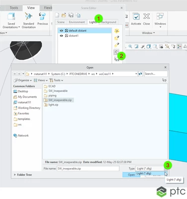

Like @MartinHanak hinted, the file is old and dated from Pro/ENGINEER 17.
I gathered an internal information that the support of lgh file has been discontinued in 2015.

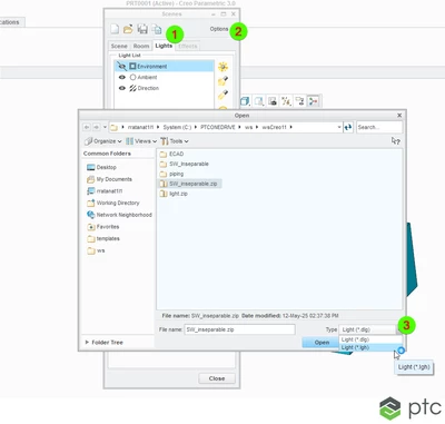

Regression tests reveal that support is active up to Creo 3.0.
Starting with Creo 4.0 only .dlg files are supported :
just comment ... your file contains following line. I guess such file is not compatible with Creo 7, 9 , or 10.
#Pro/ENGINEER TM Release 17.0 (c) 1988-96 by Parametric Technology Corporation All Rights Reserved. 97045
I saved lights in Creo 10.0.6.0 and attached it to this reply ... lights_Creo10.dlg.

@remy Thanks for checking internally on this.
This is a link to the Creo 12 documentation, it clearly states that .lgh files can be loaded. Based on your findings this documentation is not accurate and has not been since Creo 4.
To Open a Light File
This should be corrected by the documentation team. Internally how are documentation errors reported and addressed? Is there a way to open a case for documentation problems?
If I were to send you some light files are you able to open them in Creo 3 and save them as .dlg files and send them back to me?
