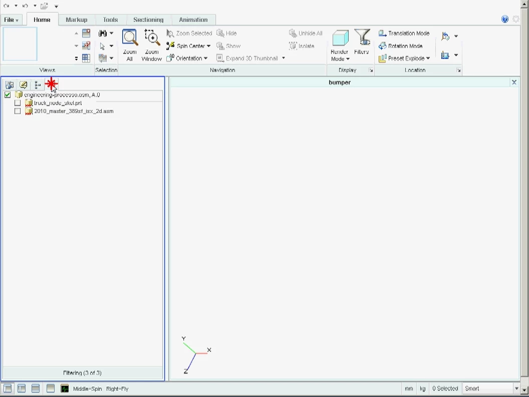

Here is the workflow associated with the Video.
A user created an annotation in Creo View of a few objects from a large 150% BOM Assembly.
Now where the video starts.
Another user wants to look at the annotation. Here is the key....we don't want to load the entire model in Creo View to see the few objects associated with the annotation. It would take 45 minutes to load.
Is there a process in Creo View that enables this functionality to Autoload only the objects associated with the Annotation?
