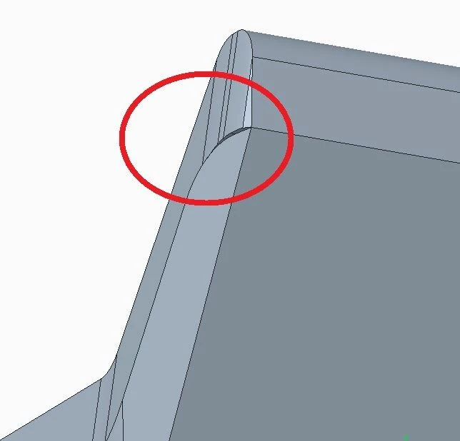

What I from time to time need is to be able to draft 2 sides dependently but carry at least the minimum draft value to both sides.  The problem is that many times the thickness from the depth from the parting line along a part might favor the top side as well as favoring the bottom side.
There is a hinge in both the top and bottom, and the draft has to be additive.

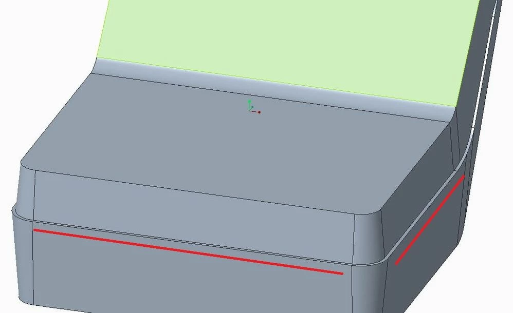

If you draft each side independently there will be an overbite noticeable.bottom dominant.JPG
If you look near the red lines you can see that by drafting independently the overbite is on the bottom impression in the above picture.
Looking to the next picture however you can see in the red circled region that the overbite is on the top side.top dominant.JPG

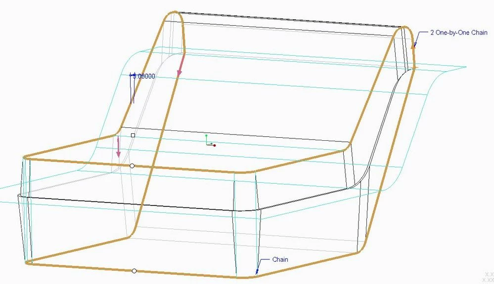

What I need to do is match draft to where a minimum value of 5 degrees is held on both sides.
If I draft these sides dependently I could either favor the middle picture side or the bottom picture side.  The problem is that one side will be exactly 5 degrees while the other will have a region or regions less than 5 degrees.
In our line of work we have to have a minimum of 5 degree draft in order to achieve separation from the dies.
If there is no solution for this I imagine that I could draft both sides 5 degrees, build a sketch with the outermost draft extent from each side taken to the parting lock split.  Then I would need to generate an intersection to the parting face with that sketch.  After this I could build a swept blend or independent ruled surfaces that join at the parting lock.

The way you are doing it the top and bottom of the part remain the same size and the center is growing with the draft.  What about creating a curve at the parting line intersection and using that curve as the draft hinge so that the top and bottom get smaller with the draft?  Then you could use a single draft feature, split at draft hinge, dependently at 5 degrees.

I have tried this type of technique but I don't believe this would work this specific application.  The customer won't want the extra stock that would be incurred by drafting back the largest combined profile.
December 17, 2018
Perhaps I'm not understanding your concern, but I would think the geometry is the geometry, regardless of technique.  If you require a certain minimum or maximum size and a certain minimum draft, you're going to get what you get.  How you get there is immaterial, I would think.

Draft one side, the one that makes sense, then sweep a cut around the other curve with the section normal to a plane parallel to the surface.  This will give you a parting line wherever it ends up.  If you absolutely need the parting line in a particular location, you could sweep a section adding material using the surface you have shown and the upper and lower edges as trajectories (turn on variable secion option).
Also, realize that the geometry simply may be impossible to create like you wish, you might have to adjust your design.

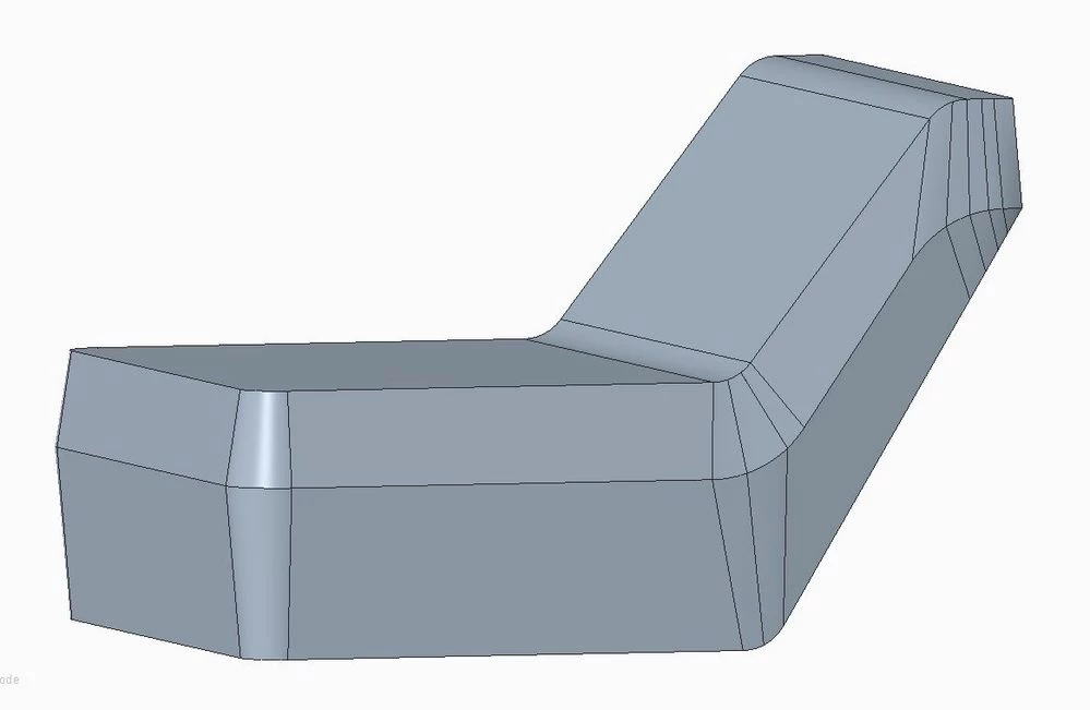

Just FYI I will show you what I end up with by combining 2 boundary blends (which were solidified out of the original shape).
In our line of work this would be a typical application of match draft.  Where you hold the top and bottom lines in the die and you have to adjust draft to meet at the parting line.

What I am trying to do is hold the hinge curves (see 1st picture in my post) and have at least 5 degrees draft where each side meets the parting lock.
