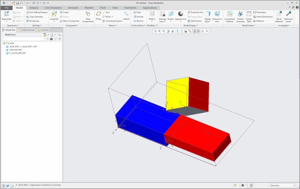

Hello together,
since we change from Wildfire 4 to Creo 4 i have a problem with color in assemblys when i using "save as" to create a new assembly.
The assemblys are generic and family based. A lot of the integrated parts are also generic and family based.
Example:
asm_genreric (with instances e.g. "asm_1" and "asm_2")
--part_red (generic with instances "part_red_1" and "part_red_2")
--part_blue (non generic)
All parts are colored (red / blue) before they are inserted in the assembly. The color should be always the same.
No color assignment is made in the assembly!
When I open a instance assembly e.g. "asm_1" with the part instance "part_red_1" and using "save as" and open
the new created assembly the "part_red_1" is no longer red and have the standard Creo color.
The non-generic part "part_blue" is blue.
I try this with Creo 4 and Creo 6 (new standard installation) and the system colors. With standard material assignment and without.
In both cases I have the problem, that the instance parts loosing their color.
Have anyone the same problem or maby a solution? Thanks.

please prepare data set for testing purposes, put into zip file and upload zip file.

Hello Martin,
here is a sample assembly with family table. Inside is a generic part and two "normal" parts.
If you open the instance "_ASM_COLOR_TEST_1" and use "save as" the part "_BLUE_PART_1" lose the blue color.
Thanks that you take a look at that!
Kai H.
To exclude configuration errors, I using Creo 4 M100, with standard configuration, standard colors and no material assinment.

I cannot reproduce your problem in Creo 4.0 M120. See attached picture and xx.asm.
