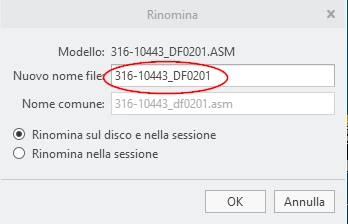

I'm testing the new Creo version 9.0.0.0.
I detect strange behavior on my very simple macros.
Simple example: macro that starts the rename command (File >>> Manage file >>> Rename).

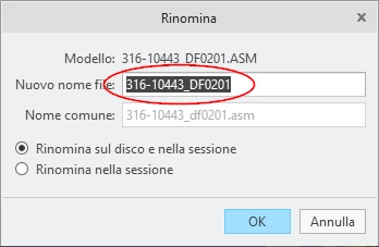

In Creo 8.0.0.0 the "New file name" text field remains selected before being immediately modified or copied.
Creo 9.0.0.0 this field is deselected.
Weird thing is that if I manually perform the above steps the text field is correctly selected, while if I run the macro the text field is deselected ...
I have developed thousands of macros but in no way can I solve the problem brilliantly.
Can anyone help me?

I investigated my problem and it seems to come from having set the option in config.pro:
visible_mapkeys NO
changing it to YES, everything returns to working correctly.
N.B.
The visible_mapkeys option, which I never quite understood what it does ... I set it to NO both when I was working with Creo 2.0 and Creo 8.0.0.0 and it never gave me any problems.
