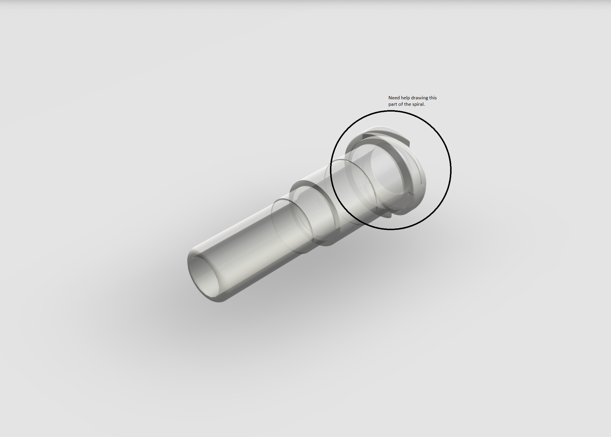

Hello PTC Community,
Does anyone know or where can I find a video to draw Luer Lock. I am pretty new at Creo and I am independently learning it. Any help would do! Thanks.
-Peixiong.
October 28, 2013
You use helical sweep for this. This thread has two starts so you might make one and pattern it around the axis.
October 29, 2013
Okay I understand that there has to be a helical sweep but will the sketch before the pattern be the same as drawing a screw?
October 29, 2013
The shape of this feature is a rectangle from what I can see in the provided image.
