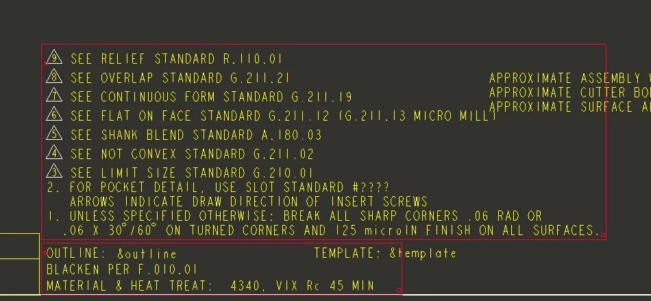

Pro/Users,
Is there a way to control drawing Notes to remain fixed in at the Lower Left? Currently every line added to an existing note causes the note to grow in a descending direction. This is undesirable for our starter drawings since the "general" notes will grow to overlay the "material" notes on our formats.
Our general notes read ascending and as we add lines onto them I would like the Lower Left edge of the note to stay in the same position (i.e. the note grows ascending, toward open area). I realize that simply moving the note after editing works, but Is this possible? Thanks.
