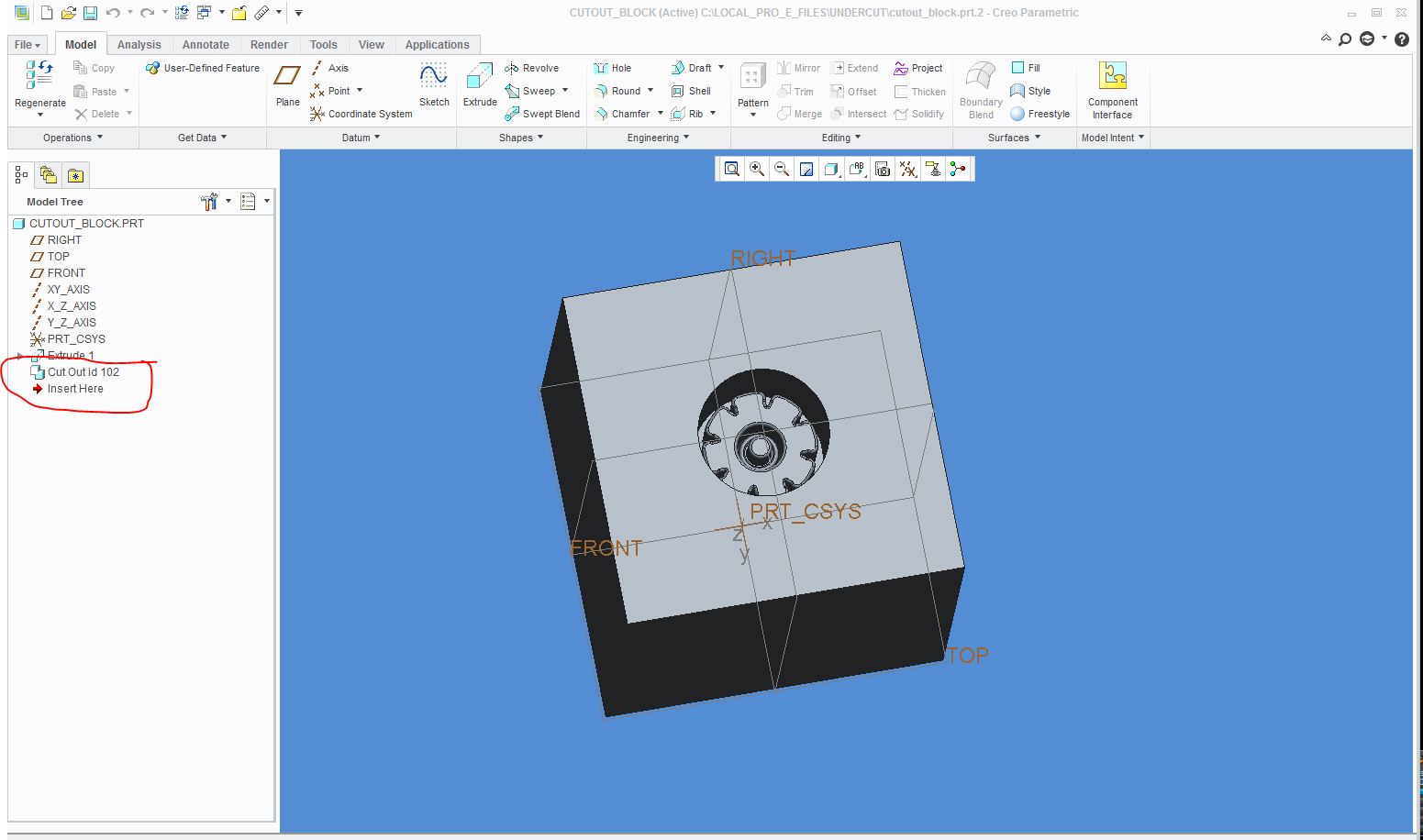

im trying to make a fixture to clamp a component to. I have a part model of the component and want to nestle this in to a billet. Is there a way I can put the model into the billet then remove the part leaving me a cavity of the part so I can machine the billet.

Michael,

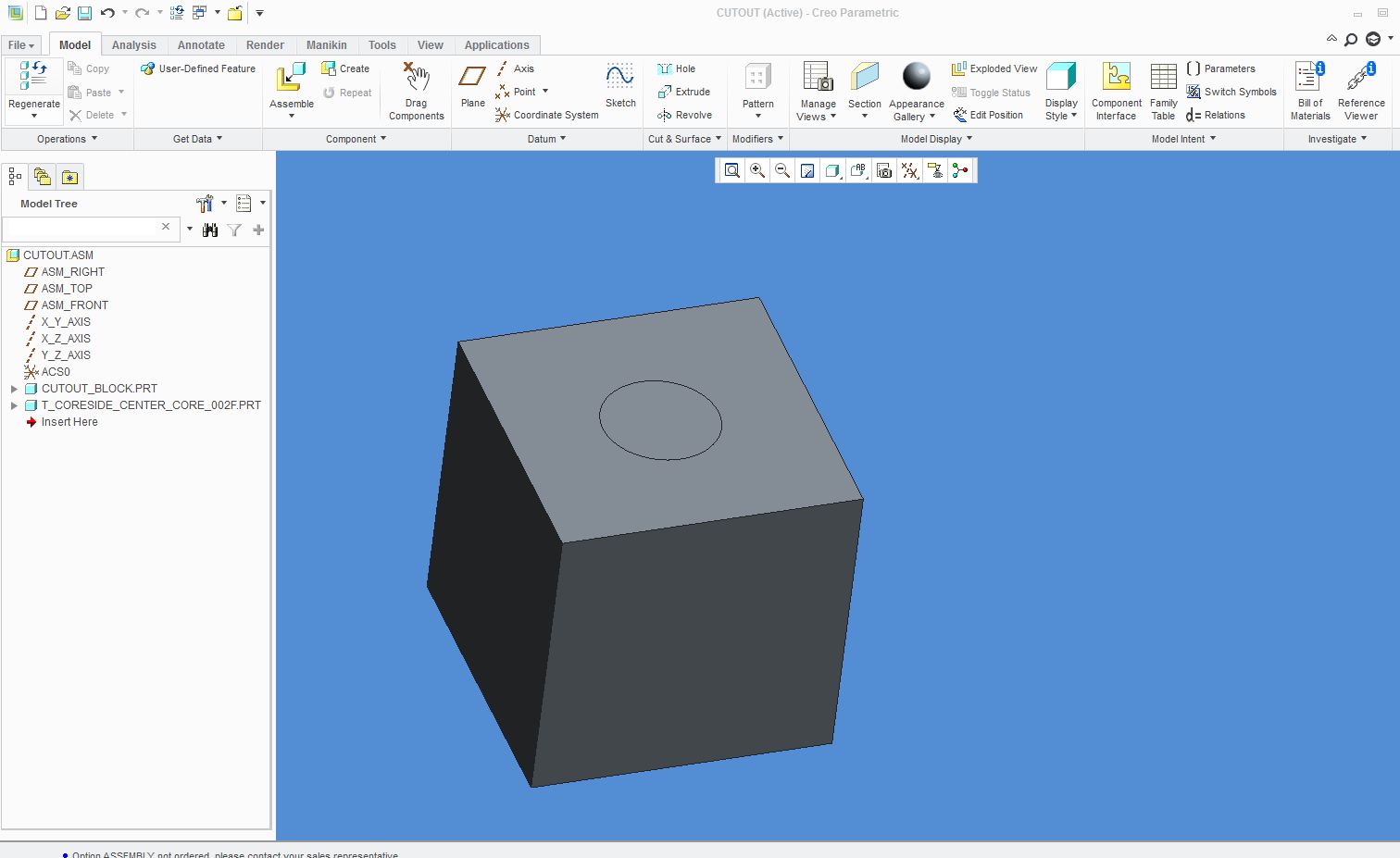

You don't need the mold tools to do a fixture. What you do is make a block to represent your fixture. Then assemble the fixture block with the part you want to fixture inside of the fixture block. then go to component operations and cut out. select the fixture block you want to cut then the cutting block which will be your part.
This is my assembly.
This is my fixture after the cut out operation. It is an exact match of the part that did the cutting.
Now you can assemble this fixture block in your manufacturing file. and use it to fixture your parts.

Thanks guys,
you are all very helpfully , thanks Steve it worked a treat will save me a lot of time.
