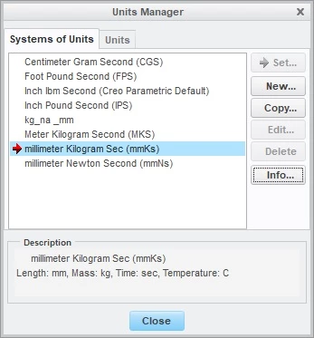

My prt and asm units are setup on millimeter Newton Second (mmNs).
So pro_mp_mass is in tonnes.
However, I would like to dispay mass in kilogram on drawing.
Is it possible to manage the unit of pro_mp_mass in a drawing table ?
(Without to write a relation in each part like "my_mass=pro_mp_mass/1000)...
Dominique

Hi @Dom_CHENTRE
 change units in your models to mm kg sec. Change it in your start templates for future using...
It doesn´t matter if you are using Kg or Newtons. Only diference can be in FEM analysis. The output from calculation can be in MPa instead of Pa. No influence for regular modeling.

If you can't change the models' units, and you don't want to write relations in the model, then maybe consider writing relations in the drawing table.  You just need a repeat region - even a single cell repeat region will work.

When the cell contains "Pro_mp_mass [.1]", I get the weight
When the cell contains "Pro_mp_mass [.1] / 1000" or something like that, I just get this line as a text.
Where could I found where to find how to do ?
Dominique
June 7, 2018
You need to use "repeat region relations".  Maybe start here:
http://support.ptc.com/cs/cs_27/howto/dwt_relt/dwt_relt.htm
