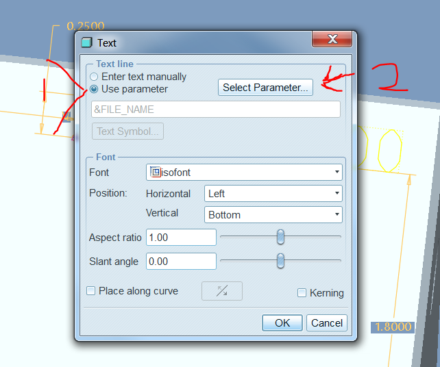

here is what I do you may be able to adapt it for your needs. I add this realation file_name = rel_model_name
I then create a cosmetic groove and point that to the parameter.
February 12, 2014
oh that is cool i just started theextrude tool and created text with the text tool and selected the parameter. and now i have some sweet extruded letters
