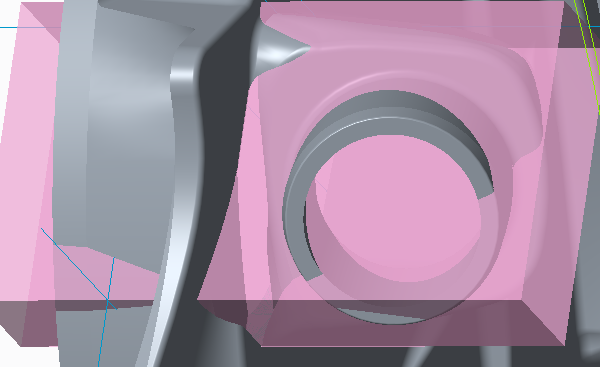

Posting this question for a co-worker, will do my best to use the correct terminology.
Creo 3.0
In Mfg he brings in the “stock model” (raw casting)
Next he brings in the “reference model” (finished part)
Both models appear normal on the screen.
Hits a menu option “Play Path” seems to work , and displays on the screen correctly.
The problem:
He wants to use the menu option “Material Removal Simulation” in Module Works. When he makes this menu selection, the casting and finished part disappear and we find two messages in the Creo message log window:
“Could not tessellate stock model”
“Could not tessellate reference model”
Any ideas?
He has used the "Material Removal Simulation" before and it has worked correctly.
He has also had the error before, so it's not unique to this current part.
Thanks for your feedback.   Bruce

A little progress to report but our problem is still not fixed.   My co-worker tried playing with the Classify pick and it's sub menus.  He thinks he understands the intent of the "classify" button now, but it did not provide a fix.
We discovered the raw casting model (a creo.prt file) had several geom checks.  They were all related to rounds that didn't have any bearing on the machining we are trying to do so I deleted them until I had a geom check free model.
The cleaned up raw casting model was brought in and we got further.  One error message is gone but we still have the problem of the raw casting (work piece) not displaying and we still have this error: "could not tessellate stock model"
To me it's counter intuitive.  The raw casting we fixed still has the problem but the reference part errors went away.
Is that a clue to someone smarter than me?

Found the problem !
I kept wondering that if the casting model was the problem, could it be "healed" by translating it into another format then back into a creo?  Creating a step file didn't give us results so I next tried creating a .stl file.  I didn't research it but was hoping the .stl could then converted back to a .prt file somehow.
The first attempt at creating a .stl file failed with these error messages:
"Unable to triangulate highlighted surface. Aborting output."
"Unable to triangulate part BDP146-P4-040C_REV_03_3.  Aborting output."
I couldn't find the highlighted surface but the message led me to believe the software identified a problem that was localized.  I found the problem area by:
- creating a cut  (side view) as the last feature in the model tree and hacked away 90 percent of the casting.
- retry creating the .stl file.    (success!)
- edit the side view cut to re-introduce the casting a chunk at a time.
- repeat the process until the .stl creation fails again.
In this case I was able to narrow the problem down to a small area.  I changed the side view cut feature to a surface so I could see where I had been and next went to a front view and used the same method to narrow down the problem area even more.
It appears the problem is in a round that was built with surfaces in an area of the casting that's nasty to work on.  Since we are crunched for time, I left the cut feature that found the problem in place and used it to just remove the problem.  My co-worker was so happy when it worked he offered to restore my 1960 Chrysler!  No, not really.
Summary:  I don't know why the problem exists but it is related to a round between two complex surfaces.  Geom checks didn't flag the problem, but a .stl model could not be created because of the problem.  The .stl creation process was used along with cuts to remove material to get a work piece that would display properly in mfg.
