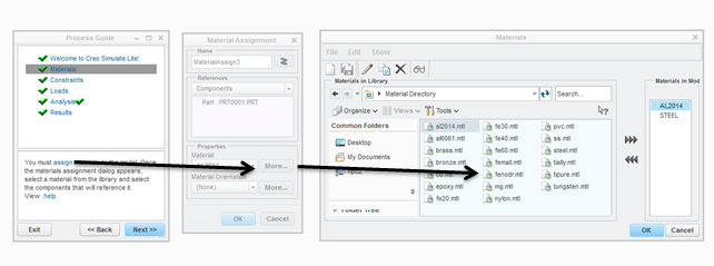

Frustration level is a 7.7 at the moment. I have two materials that I want to run a part in to compare in Simulate Lite. However, I cannot get the material to change from one to the other. Even going back to the "Part" and using "Prepare, Change Material" will not effect a change over in Simulate Lite.
Can anyone shed some light on this issue?

What version are you using? I did the following in Creo3 M030.
From within Simulate Lite I am able to change the material properties using the 'assign' link at the bottom of the 'process guide'.
if I change the material I get the following dialogue:
I am able to re-run and get different results
I can also do this via the model tree from within Lite by right clicking 'material assignment'
I find when I delete the material assignment using the model tree, the process guide does not update until I try and run. It then fails stating that there is no material; which is true but late.
From within Parametric I am able to use FILE > PREPARE > MODEL PROPERTIES .... remembering to RIGHT CLICK ASSIGN
These properties are used in Lite even though I have other materials in the model 'loaded' when in Lite and I haven't used Lite to assign a material.
I can delete materials in the model via the model tree when in Lite. I can delete ALL materials from the model via the model tree. This is a change of behaviour from earlier versions of Simulate/Mechanica. It used to be that the material assigned in Parametric could not be deleted from within Simulate/Mechanica.
What should be changed is that when I assign a material in PARAMETRIC using FILE > PREPARE > MODEL PROPERTIES, then reassign in Lite using the 'assign' link at the bottom of the process guide, there is no warning that something is being 'overridden' (when I have seen it think the message uses the word 'hidden') in favour of my latest material selection.
This last point is something that happens in Simulate too. A model has material properties assigned but unless one is diligent enough to check the part in parametric there is no way of telling. A material assignment should automatically be created and visible in the Simulate model tree if a material was assigned to the part in Parametric.

Charles, I have tried all that you have suggested. Assigning and un-assigning both in and out of Simulate Lite does not give me any love. I can get to the Confirmation Window you have shown above, answer yes to both prompts and the material will not change. The only thing that has "worked" is I have gone as far a deleting ALL the materials AND the constraints AND the loads, save the model, exit (Creo2, by the way), come back in and assign the material I want. That is no solution but the only thing that seems to work.

I think my frustration yesterday was clouding my exploration and vision.... I got back into this part this morning and found the only way I can change the material for the FEA, is to delete the multiple materials in the part. In other words, I can have only one material designation at a time in the "FILE, PREPARE, MATERIAL PROPERTIES BOX. Even un-assigning (Material A) and re-assigning (Material B) does not give the ability to change it over in Simulate Lite. It gets "stuck" on whatever material is holding on in Lite.
It seems to be a bug to me. I am off maintenance so I cannot create a Product Idea.
