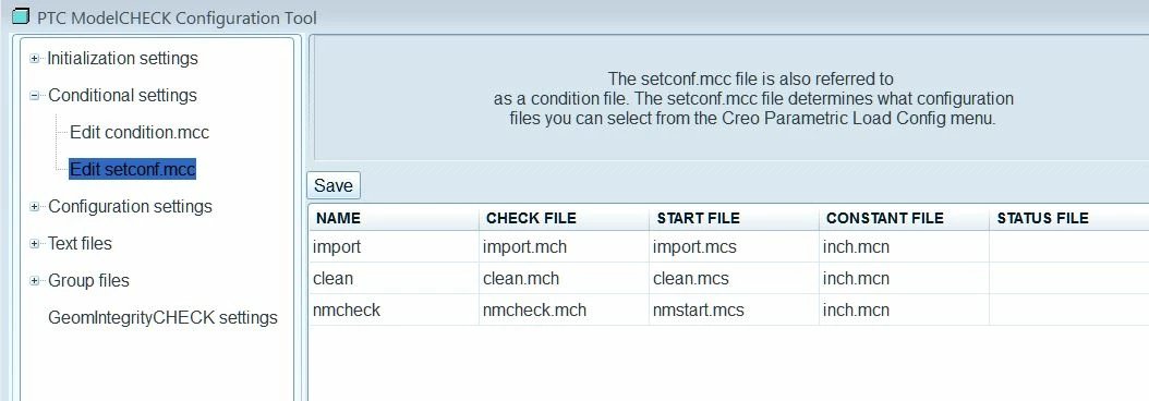

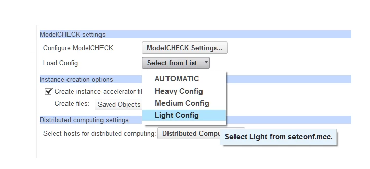

In Modelcheck I have edited the setconf.mcc, changed the names of Heavy, Medium, Light
They keep showing up with the original names ??
Restart Creo, yup my names are still good, go to Load Config drop down, old names listed.
Config_init.mc (CNFG_SELECT_AUTO) = N
All .mch, and .mcs files are in there respected folders.
Does this in both Creo elements pro 5.0 m170 and Creo 2 M040
