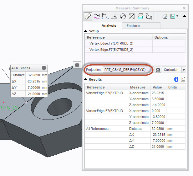

December 13, 2013
SolidWorks infection my eye! ...and I'm putting that nicely...The SWX measure tool gives you Delta XYZ and always has. I'm actually having to break out my calculator and subtract X1 from X2 to get delta X, etc. in CREO. This is 3D CAD 101 and I'm dumbfounded at the oversight.
September 24, 2014
This can be done without your calculator. See the image below. After you pick the two pionts, you need to activate the Projection collector (outlined in red) and hold down the control key as you pick the CSYS you want to use for your x,y,and z components.
