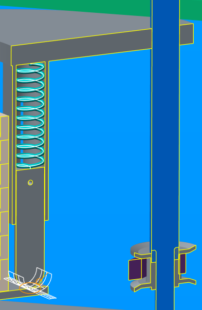

All,
I am trying to define a spring in a mechanism similar to a spring plunger. I have a cam connection (with liftoff enabled) at the bottom. When I move the sled down, the spring compresses as it should. However when I travel the opposite direction (so as to allow the spring to de-compress), the spring plunger immediately lifts off the surface and the spring does not decompress. It remains in its previously compressed state. Does anyone have any idI have Creo 2 with MDX and MDO. Gravity is enabled and materials are assigned.

Hi Mark,
I am not familiar with the MDX and MDO applications.  But if you could upload a model to the discussion, perhaps that would help another contributor troubleshoot the issue.
Amit
January 21, 2016
Are you running a "dynamic" analysis?  "Position" and "kinematic" analyses do not take into account gravity or spring forces.
