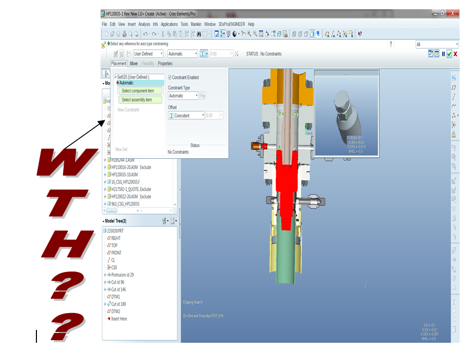

March 12, 2012
In assembly mode when you are adding a constraints...that box is locked in place and covers up constraints Iwant to select...GRRRRRRgrrrrrr.PNG
