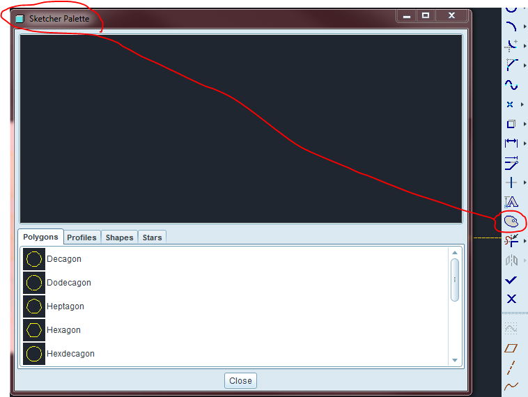

Suggestion - add commonly used shapes to sketcher. examples - round ended slots with the origin at centre, hex shape, keyhole shape (round slot with larger hole at one end), rib shape (narrow rectangle with angled sides, with pre-defined angle dimensions on sides), drilled hole sketch for rotated cuts (rectangle with 59 deg angled bottom edge), T shaped sketch for T slots, triangle sketches, one sharp one with radisued corners.
Thanks Jeff Dayman
March 26, 2012
Some of that can be found in the Sketcher Palette
