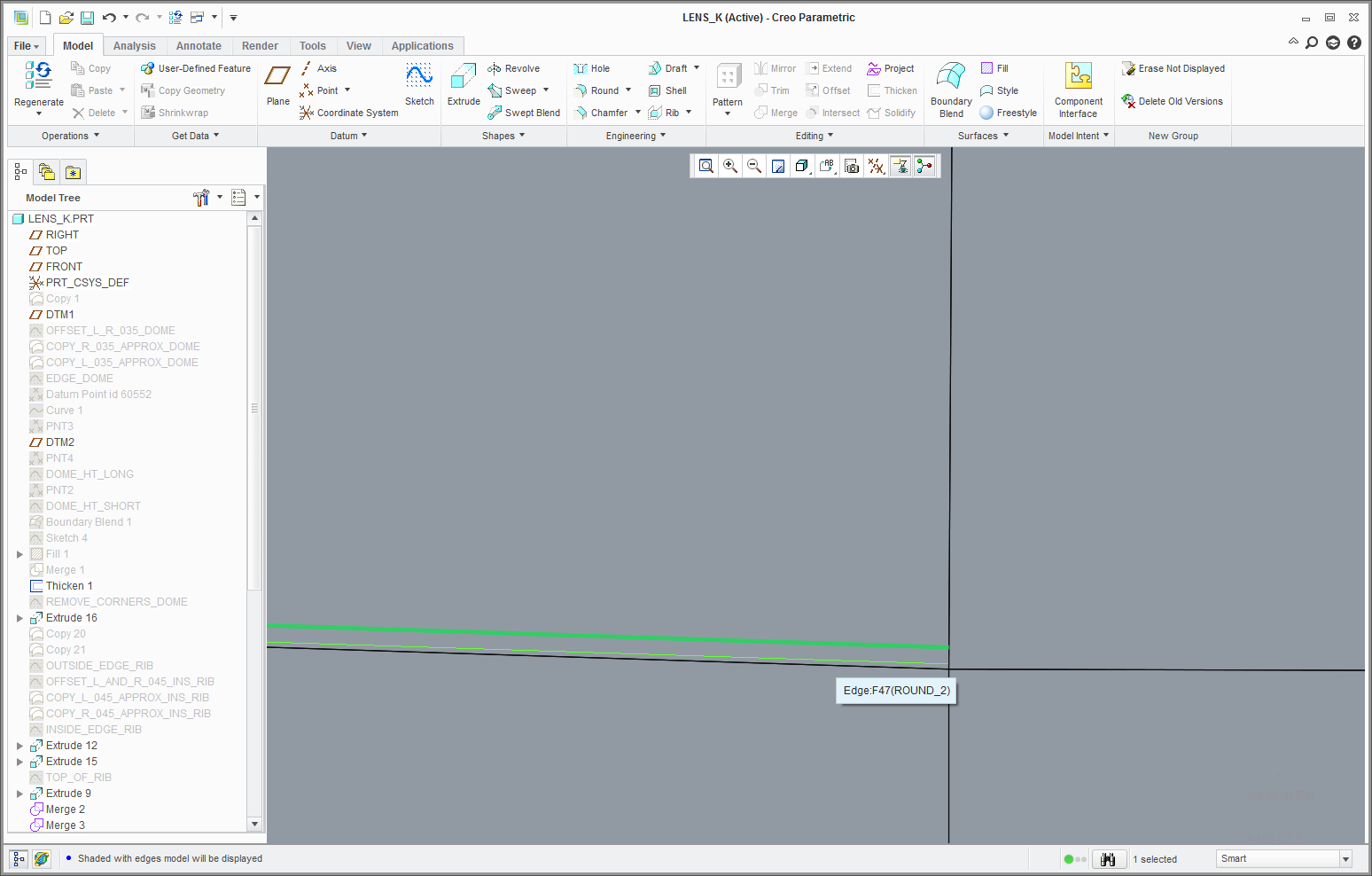

2. I have never seen such an issue with other CAD packages where the shaded image does not match the wireframe image. Tech support said this issue started in WF 3 (I think). To your point, the inaccuracies may explain this at the micro scale, however I don’t understand the mismatch at the macro scale (see #1 in my first post). It may be “no big deal” but it adds to a sense that Creo is sloppy. Remember the first Pentium? The screenshot below is at max magnification. The settings are at Edge Display "Very High" and Shade Quality at 10. Notice the surface edge does not match the pre-highlight of edge, which does not match picked edge.

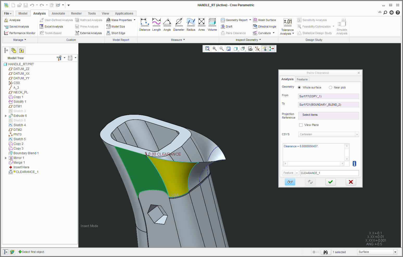

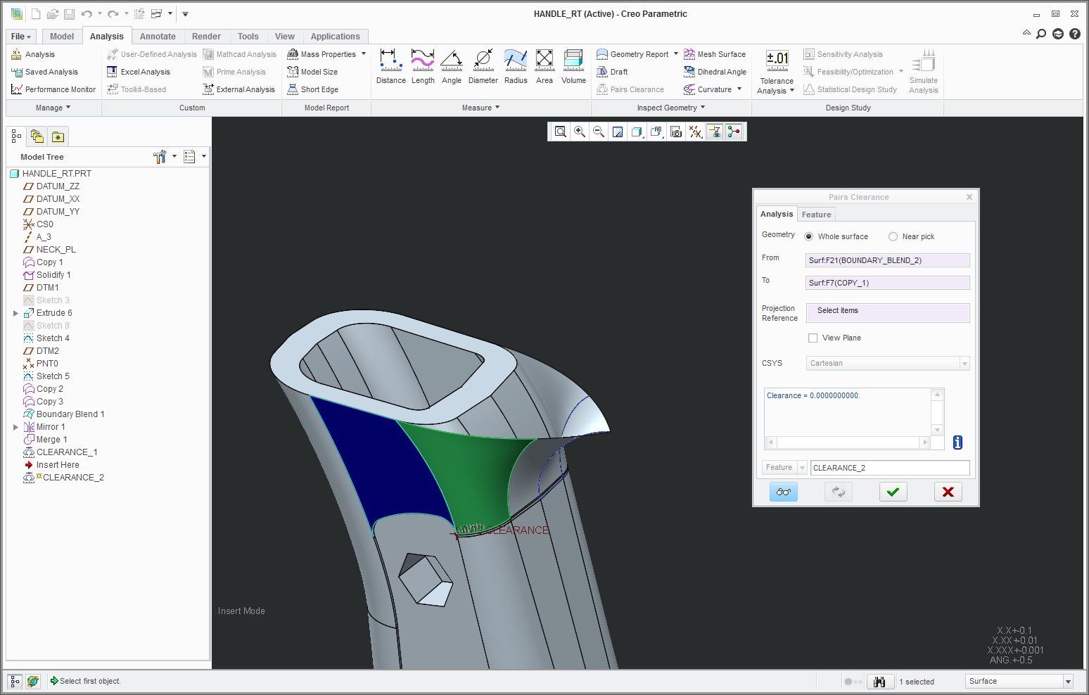

3. The screenshots below show the clearance from surface A to B is 0.0000056457 while B to A is 0.0000000000. First problem is that the issue happens at all; second, it happens inconsistently (I remember one other occasion, but can’t recall where). The value is small but anything other than zero prevents feature completion in Creo. Again, it adds to the sense of unease about Creo.

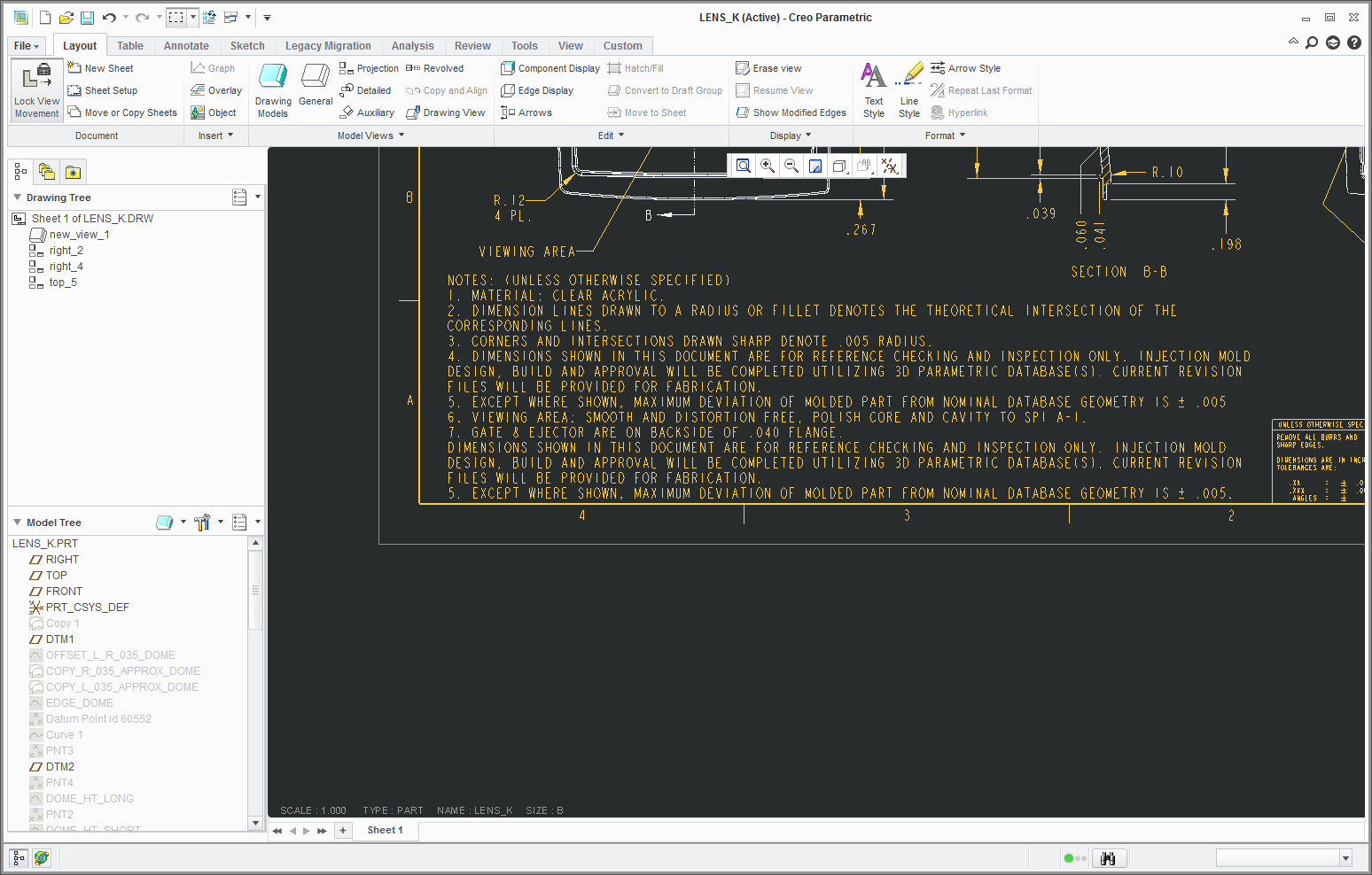

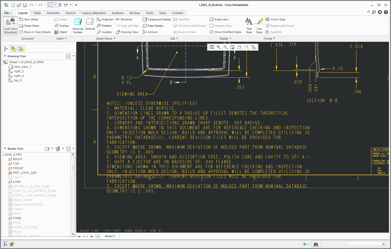

4. Yes, this is some word wrap issue. There is a work around by adding hard returns and tabs for the hanging indent spaces. It was a surprise to find that what you saved is NOT what you get. A vendor or customer would think I did sloppy work if they saw notes beyond the border. It’s just one more thing to double-check. I have suggested, since the text editor is inadequate in such cases, that Creo should allow the exterior lines of tables to be blanked. Then spacing of multi-line notes can be controlled by a table.
