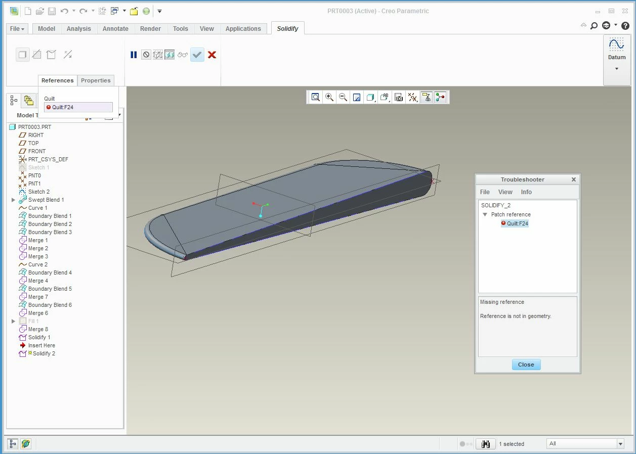

I have created a solid feature by merging quilts. When I try to mirror the feature, I get a "reference is not in geometry" failure - even though this reference was used to make the solid part. What causes this type of failure and how is it fixed? Thanks.

I see one solidify in your model just before the one you're attempting. That's a clue. I'll take a look at this and get back to you.
What type of mirror are you using? Are you doing anything special?
May 25, 2012
I could be wrong here but if you are just trying to mirror the solidify feature you are going to have problems since it depends on the surface geometry which needs to be mirrored for the feature to be created or you can try selecting PRT0003.PRT in the model tree and mirror.
