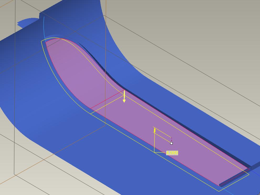

So, one of the engineers I work with modeled a part. He did a lot of surface modeling to get what he wanted. He thought he would save some time and just modeled half of it. The idea was to mirror it after the design was the way he wanted it.
When he started trying to mirror the part it came back with all kinds of geometry errors.
He contacted me to see if I could help. I started mirroring different groups of features in the part. I found that the first several features mirrored successfully. Then, mirrors after that would fail.
As I inspected the part I found a hole.
I cannot seem to put in a second picture to show what I found so I will edit this one or add a second post to get the next picture.

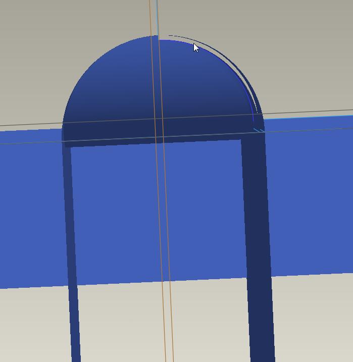

After closer inspection of the mirrored feature (an offset) that should have covered that hole I found this:
Pro/E is not mirroring the entire feature. Instead, Pro/E mirrors the offset that has already been trimmed.
This seems like a major bug in Pro/E that would allow it to mirror the future state of the object instead of how it was at that point in the design. It correctly shows the features in the model tree, just does not recreate them as that were at that point. No wonder mirror does not always work properly.

I largely abandoned the use of "mirror" functionality ages ago. It's nice on occasion, during the early "cocktail napkin" design stages, but there are too many issues which come up. Mind you, I'm talking about mirroring features, not mirroring elements in sketcher, which works perfectly well.
Most of my issues with solids mirroring came about as a result of dimensioning/tolerancing issues (which is worse when working in "intent manager" as your sketcher). But that wasn't enough to explain ALL the issues I've seen.
The biggest problems I've had have come from models "collapsing" when you change the model accuracy if the model contains mirrored features. Similarly, I've seen "collapses" caused by surface-based modeling being mirrored (ie, creating body panels as NURBS features, thickening them, and then mrroring them).
I've never quite understood what's going on "under the hood" to cause this, but I have learned that the only practical way of repairing it is to roll back the model, suppress the mirror feature, reproduce it as an explicitly defined feature, delete the old mirrored feature (being careful to suspend, not delete, all child features) and then individually redefining all child features as necessary to refer to the newly created feature.
It's not really worth it. The extra time to just create the feature explicitly up-front is a lot less painful. That's the nice thing about a parametric modeler...
Maybe PTC will make mirroring more robust in the future... but until they do, I'll just "brute force" things, which works a lot better in my experience.
