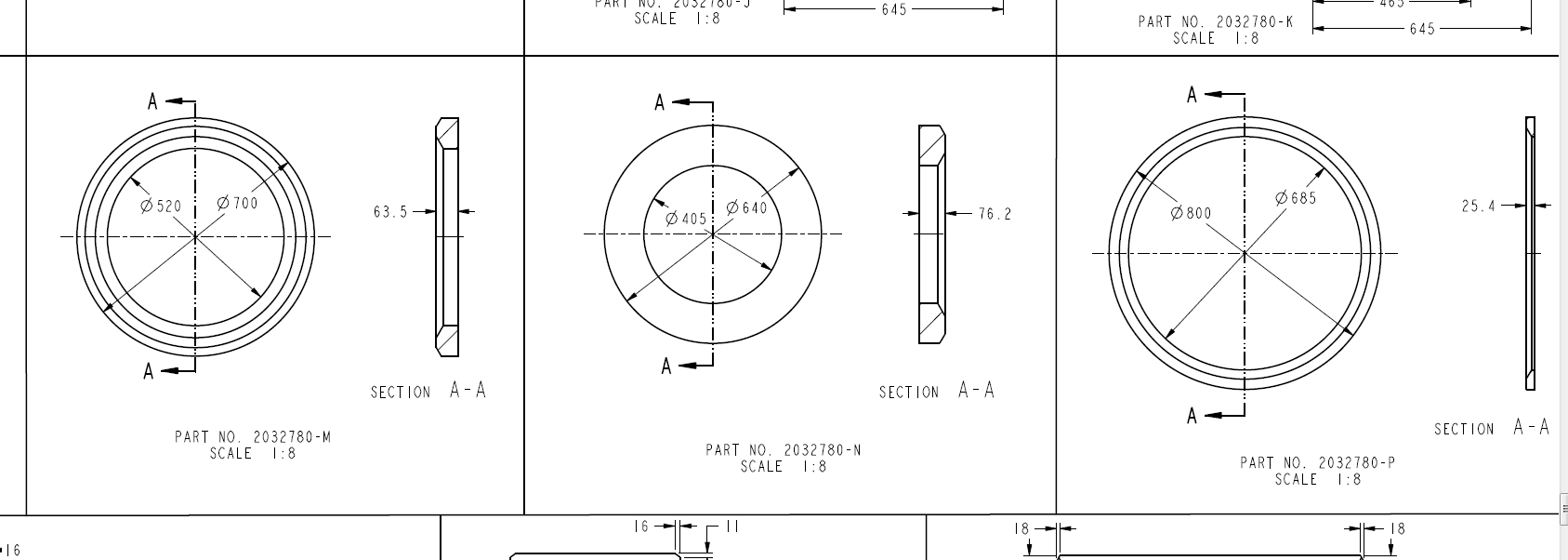

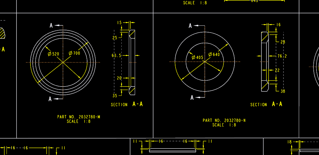

Since updating to Creo 3 M40 we have been having trouble across almost all drawings with dimensions not being printed. About 50% of the time, some (not all) dimensions are missing from the page when printed.  They are visible in the drawing in the creo window but do not show on the page when printed or when creating a pdf (using CutePDF printer).  If we just print the same drawing again (without doing anything; no regen, no update) the missing dimensions are often printed.  This is very frustrating and dangerous.  Has anyone else had this problem.

You may try this in M050 datecode, I had the same issue which was reproducible in M040 however not in Creo 3.0 M050.
