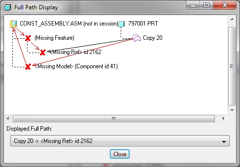

I'm dealing with an assembly created by another vendor of our client.  They evidently created a master model and then copied surfaces from the master model into the part in a separate assy named "const_assembly".  This assy does not seem to exist anymore, at least a search in the client's SAP system reveals nothing.  What I really need is that master model, but Proe won't even give me the name of the file so we can search for it:
[cid:image001.png@01CEE51E.1DB12010]
Is there any way to determine the master model's file name?

Did you right click on one of the failed features and click "Full Information" or something like that? Usually the text message that pops up includes any other data that is available.
Joshua Houser
(have I talked to you about FIRST robotics yet?)
Pelco by Schneider Electric
Methods & Tools Sr. Engineer

Yep, I tried that.  The dialog I posted is the most detail I could get.
