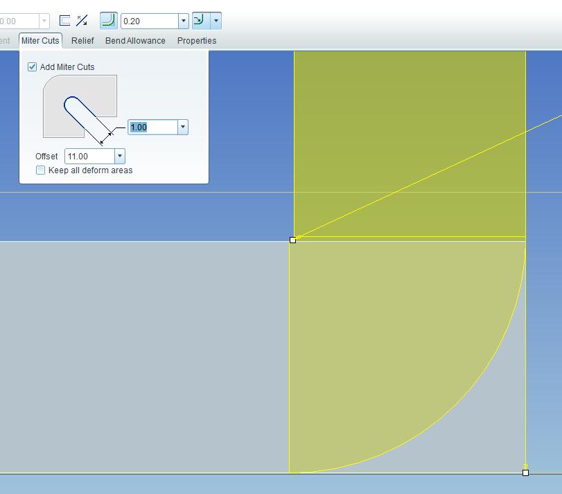

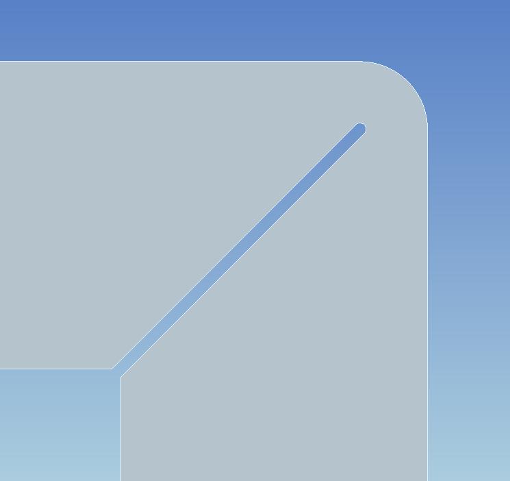

i have problem with creating certain sheetmetal part. When creating flange wall with miter cut i dont get outer bend radius as i should in real life (Alubond material).
ProE always gives me larger outer bend radius. I cant rely on its flat state because of this.
Practicly on bend, radius should behave like sheet is thiner and not use full thickness of sheet.
Is there any way of creating something like part on first pic in sheetmetal?
