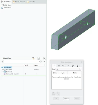

We tried several options, but none is able to mirror such features. Even worse Show Annotations does not show any elements in the mirrored part.

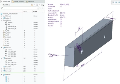

Mirror_Part_Test is the Master including GD&T elements.
Part0005.part is the mirrored part (created using Mirror Component in an assembly).
Note: No annotations can be shown for the selected objects in the dialog window when the part0005.prt or feature Mirrored Bodies id 1 is selected.

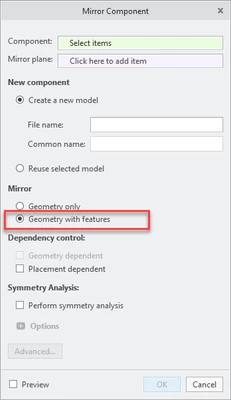

Can you please try creating the mirrored component with the option "Geometry with features" checked
If you will choose this option, all of the original annotations will be created on the new mirrored part. you can then choose to assign them to the top assembly or open it in its own window and observe that they are all shown there already

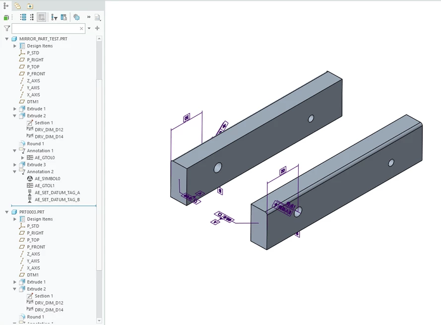

Here is how it looks from the assembly (I have assigned the same annotations from both of the components to the assembly combination state):
This allows you to leverage any existing annotations that came from the original model and add a few of your own
