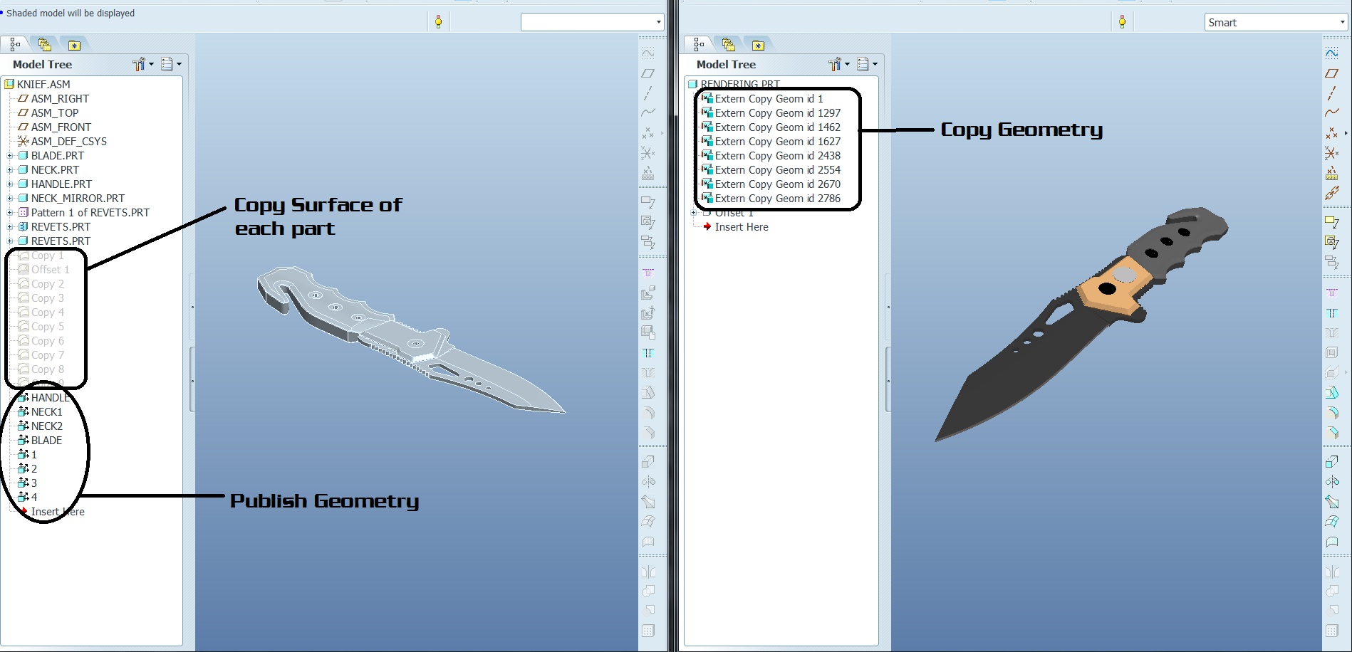

there is a way to do it which i often use, make seprate part/assembly for rendring. all u have to do is to copy all surface and publish thoes sufaces and call publish geometry in new part by copy geometry. This way u can keep both color schemes... and dont worry about changes that u will made in part or assemble it will automaticaly update.. try it and let me now
- Dalbeer
Message was edited by: DalbeerSinghSohal

There are some shortcuts to using this technique Dalbeer is suggesting.
You can create a Shrinkwrap which will automatically gather all solid surfaces of your assembly and all sub-levels (or selected sub-levels) into one object. If you create an External Shrinkwrap, you can keep the new model separate from the existing assembly while preserving associativity.
To do this, you have to create your shrinkwrap from the Insert>Shared Geometry>Shrinkwrap menu. You can't do it properly using the File>Save a Copy menu to save your shrinkwrap.
There are problems with this technique, though. In Dalbeer's method, you create MULTIPLE copied surfaces. Each one represents one part from your assembly. In my method, you avoid having to copy surfaces manually, create publish geometry, and then create external copies. However, the downside is that my technique creates ONE copied surface with sub-features representing each part in the assembly.
Both techniques appear to give the same result. Mine is faster and more automatic but with Creo Elements Pro (Wildfire 5), it's harder to assign colors to my copied model. Dalbeer's is easier to color because he has individual features. Mine are all lumped under one feature which still should be easy to color but the software really fights you when trying to select surfaces.
Ideally, you'd combine the two methods. If you make one separate copy/shrinkwrap feature for each component in your assembly, you'll avoid the selection problems my method has. If you use External Shrinkwraps or External Copy Geometry, you'll avoid carrying copied surfaces and publish geometry in your top assembly.
