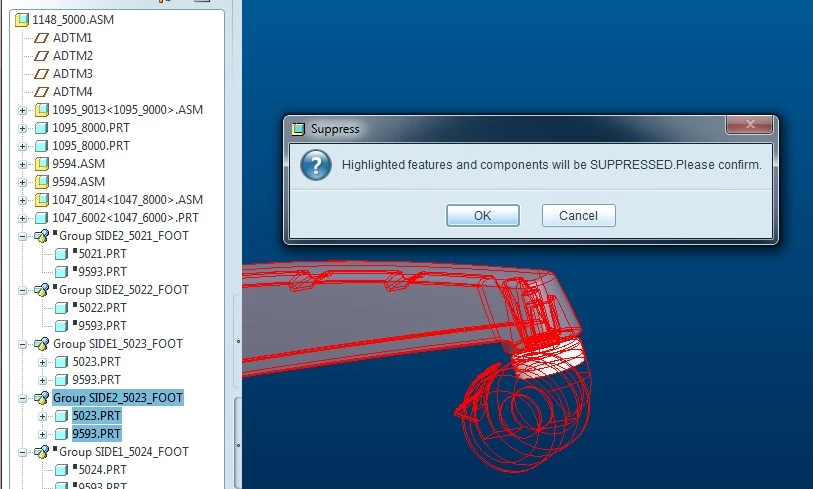

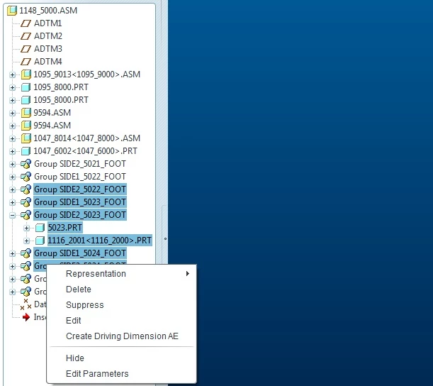

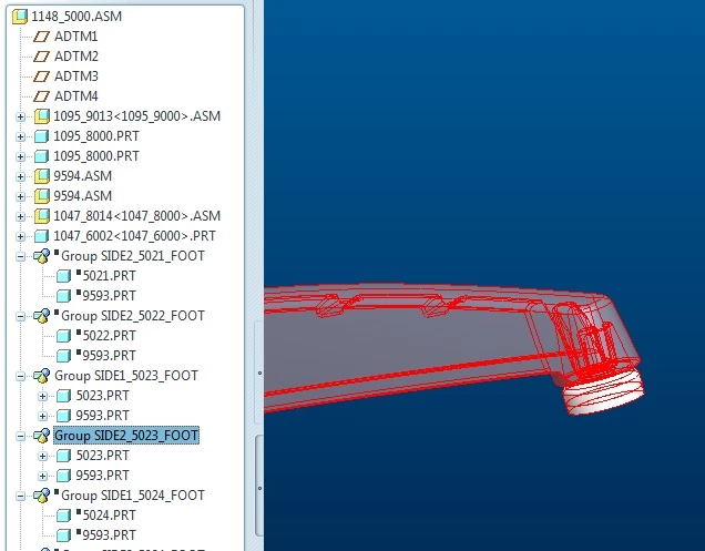

I have an assembly where the instance has a model (Picture 1), but I do not see the model in the Generic (Picture 2). Usually I'll see it but it in a suppressed state. And by the way, if I suppress the Side2_5023_Foot in the Generic assembly, the outline of the part shows up. (Picture 3)
Thanks, Dale

At this particular time I decided to delete the two groups, SIDE1_5023 & SIDE2_5023, which deleted the missing/hidden parts with them. I then added them back into the assemlby and they are now clearly visible in the tree. Sorry I wasn't able to spend more time on this, but I looked into various settings in the view tab and elsewhere to no avail.
Thanks Martin and Antonius for your help.
I am going to mark this as correct only because I don't have the problem any more not because I was able to resolve this issue.

Dale,
I guess that you assembled the unvisible component directly into the instance. I think that in such case, the component is suppressed in generic by default. Try to open generic. Then open its family table and go through its columns. I think that you will find the column related to unvisible component. I expect that the cell located in this column will contain N value.
Check the family table and let us know.
Martin Hanak
January 17, 2013
To see the component in generic, simply do Resume for it, regenerate the generic and save it.
I suggest you to check family table, again. All instances, which contain * in component's column, will now have the component visible. To hide the component, set N value in component's column.

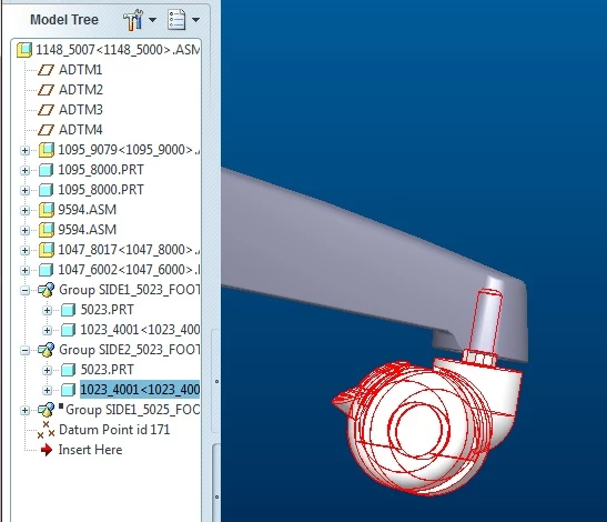

Martin,
How would I Resume the part? I know that when something is suppressed, to click on it and Resume, but what about when you can't see it in the family tree. If you compare picture #2 and #3 (above) and #4 (included here) the caster part does not show up in the tree. Is there a way to resume from the family table? Usually I cannot edit the top line of the generic in the family table, only the instances.
