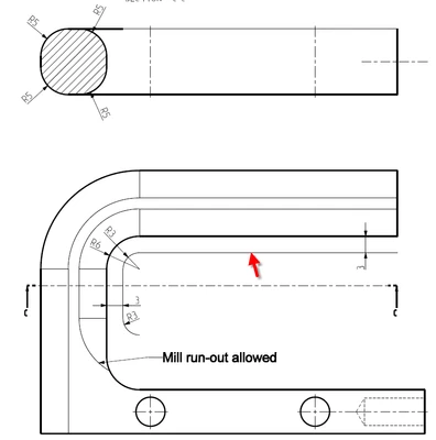

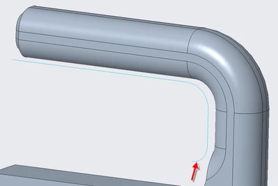

I have a 'handle type' part, that needs some edges rounded.

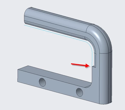

I have a problem with modelling the inner round because it has to stop 'halfway', where the red arrow is (see screenshot below).
If this part is produced on a milling machine, the round will of course not end 'abruptly' as shown below.
There will be some run-out of the radius mill.
How could I model this?
The inner round, I have now modelled as a sweep along a sketch (you can see the sketch as the blue line).
The mill run-out should look something like this:

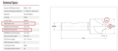

Ok, let's go that extra mile and look at an actual tool to produce the round and make the model accordingly.
This is the matching sketch:
Note that the run-out (lead-out) radius can be larger than 3, but not smaller.

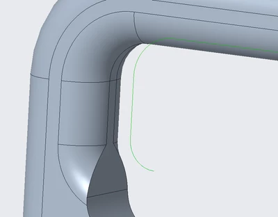

This is the sweep, modelled according the dimensions of the tool:
This is the result:

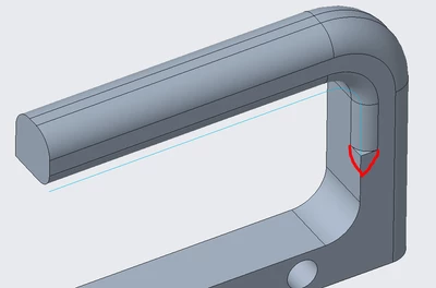

For this kind of thing, to make the model look like what I'm going to make, I will add a revolved cut at end of the sweep. Revolve the shape of the cutter in the plane of the feature end. In addition to looking good, it's a pretty accurate representation of reality. A bit of work, but worth it.

@KenFarley  and @aputman , you guys gave me just the push in the right direction that I needed.

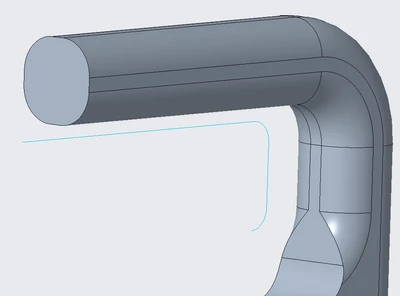

The solution (or one of the multiple possibilities) was fairly simple. The sweep along the sketch that I already had, just needed a little tweak.
I added an arc at the end of the sketch to provide the run-out path of the milling tool. Now why hadn't I thought of that!
The sweep mirrored:

@StephenW @Patriot_1776
This is the result:

Hahaha! I like it. I've used the term "Blend" to get something similar on drawing where I just needed a smooth transition out.
But it's never a bad idea to understand the tools being used to do the job!
Another option you possibly could have used is a variable radius, but honestly I think you developed a very good solution.
