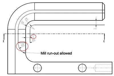

Using Creo 4.0 here ...
I have a 'handle type' part, that needs some edges rounded.
I have a problem with modelling the inner round because it has to stop 'halfway', where the red arrow is (see screenshot below).
If this part is produced on a milling machine, the round will of course not end 'abruptly' as shown below.
There will be some run-out of the radius mill.
How could I model this?
The inner round, I have now modelled as a sweep along a sketch (you can see the sketch as the blue line).
The mill run-out should look something like this:
Kind regards
Best answer by EddyVE
@StephenW @Patriot_1776
Ok, let's go that extra mile and look at an actual tool to produce the round and make the model accordingly.
This is the matching sketch:
Note that the run-out (lead-out) radius can be larger than 3, but not smaller.
This is the sweep, modelled according the dimensions of the tool:
This is the result:

For this kind of thing, to make the model look like what I'm going to make, I will add a revolved cut at end of the sweep. Revolve the shape of the cutter in the plane of the feature end. In addition to looking good, it's a pretty accurate representation of reality. A bit of work, but worth it.
March 10, 2025
You can draw a curve on the side of the handle and then create a round using the "Thru Curve" option.
EddyVE12-AmethystAuthor
March 10, 2025
@KenFarley  and @aputman , you guys gave me just the push in the right direction that I needed.
The solution (or one of the multiple possibilities) was fairly simple. The sweep along the sketch that I already had, just needed a little tweak.
I added an arc at the end of the sketch to provide the run-out path of the milling tool. Now why hadn't I thought of that!

How are you going to specify that on the drawing? I can see what you did and I see why you did it, but explaining that part of the round seems problematic to me.

Well, it depends on what level of detail you want in your model.
If you want it 100% accurate, you do need to know the pilot diameter (D1), because it will affect the minimal run-out radius.
R8 in the drawing below. A larger pilot diameter D1 will result in a larger radius (than 8 in my example).
Whether this is relevant in your design or not, was already a topic in previous posts. In my case (the part is 'just' a handle) it is not much relevant indeed.
This is the result:

Hahaha! I like it. I've used the term "Blend" to get something similar on drawing where I just needed a smooth transition out.
But it's never a bad idea to understand the tools being used to do the job!
Another option you possibly could have used is a variable radius, but honestly I think you developed a very good solution.
