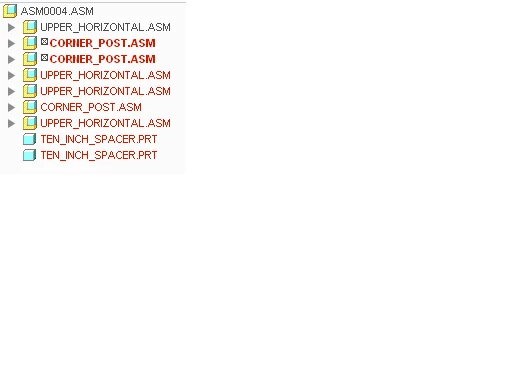

When you open something new you choose a "Name" and a "Common Name." When you save what you've been working on you have a "Model Name" and a "New Name." What's the difference between the two Does it have to do with my assembly lighting up red with "Retrieve missing component" options? Any help would be appreciative.

1.) the first is about your components are missing from your working directory.
the parts with which you have made the assembly may be in some other folder.
