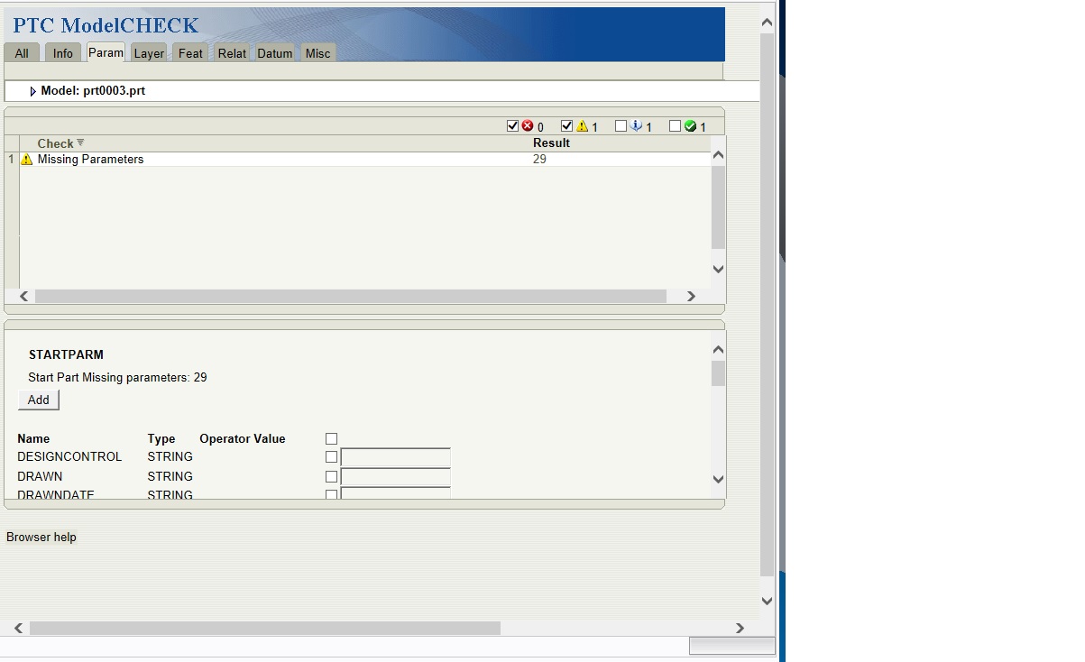

Can anyone tell me that when running model check some how to create the text box to feed value in the model...
here i am attaching a screenshot which shows the missing parameter in drawing and update those values after filling and pressing "Add" tab.

Nimesh,
Text boxes to enter values depends on ModelCHECK parameters. If any of the parameter set which results to enter values will give text boxes and if any ModelCHECK parameter is only for information there will be only information without any boxes to input.

Hi mahesh
Can you give me example of adding parameter with in which text box appear, because when  i am adding parameter it directly updates in model with null value.
I want to add the value of parameter during model check. I have edited start.mcs file with this parameters-
PRT_PARAMETER PART_NAME STR EQ *
PRT_PARAMETER DESCRIPTION STR EQ *
PRT_PARAMETER MATERIAL STR EQ *
now when i run modelcheck parameters directly goes to model, but the thing is i want to add during my model check like this image shows
