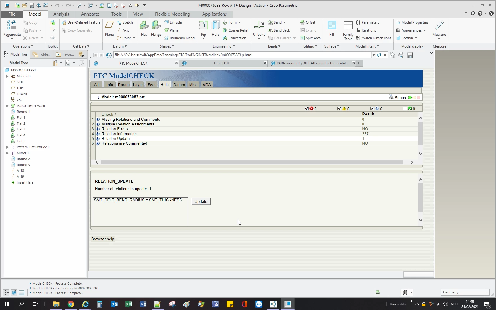

Hi

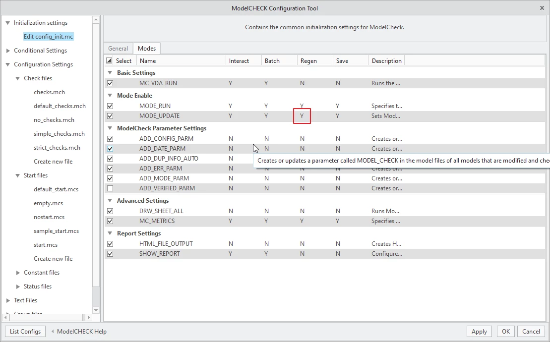

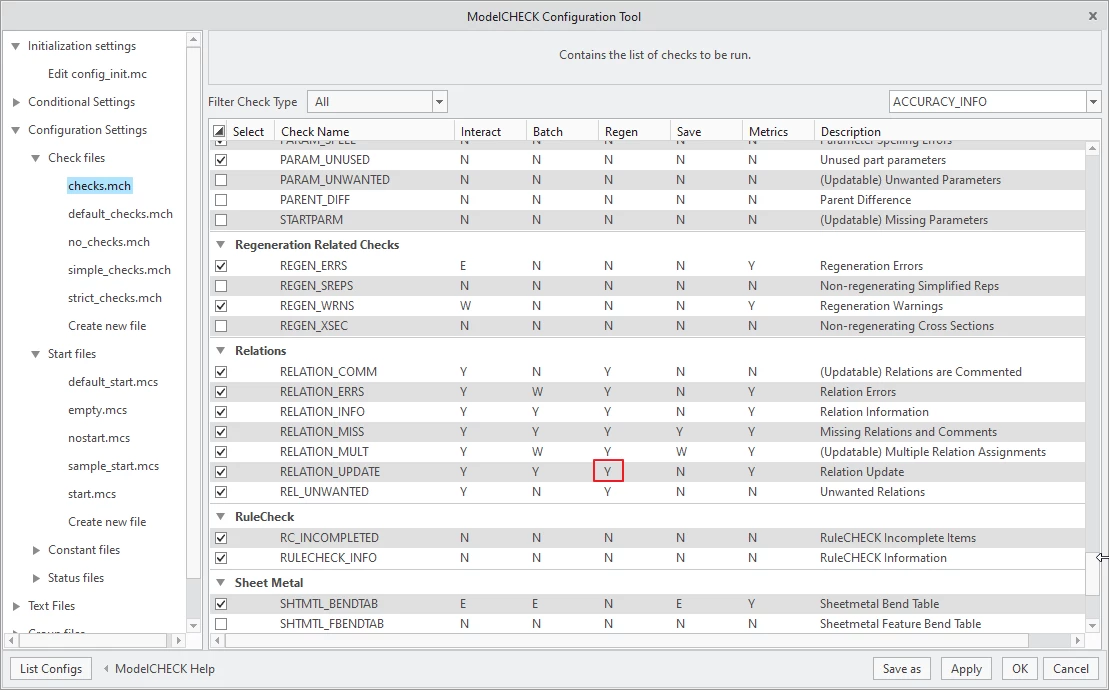

I have ModelCheck set up like this that it prompts to replace an old relation for a sheet metal model in interactive modus. But this is not happening when regenerating the model. Although all is set correctly for allowing this. Is there something I am overlooking ?

ModelUPDATE only applies to Interactive Mode and deals with automatically (without asking the user) updating checks - there's an Product Idea to allow ModelUpdate to be used in other modes.

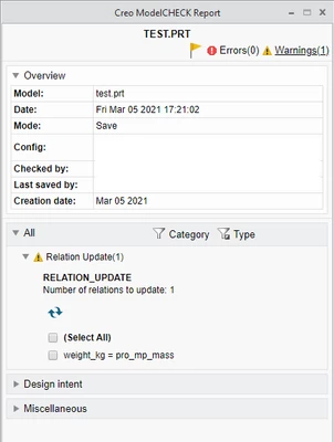

I can get RELATION_UPDATE check to work on Interactive and Save mode but not in Regen mode. Based on the help documentation it seems like it should work in Regen mode. Maybe open a case with PTC?
