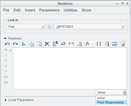

Does anyone know is it possible to add relations via Modelchecker but in post regeneration not just initial?
December 29, 2018
I opened a ticket about this issue for Creo 3 M110 and PTC told me that there is no way to add post regeneration relations using MC buttons as you can do for initial.  Pretty sad...
