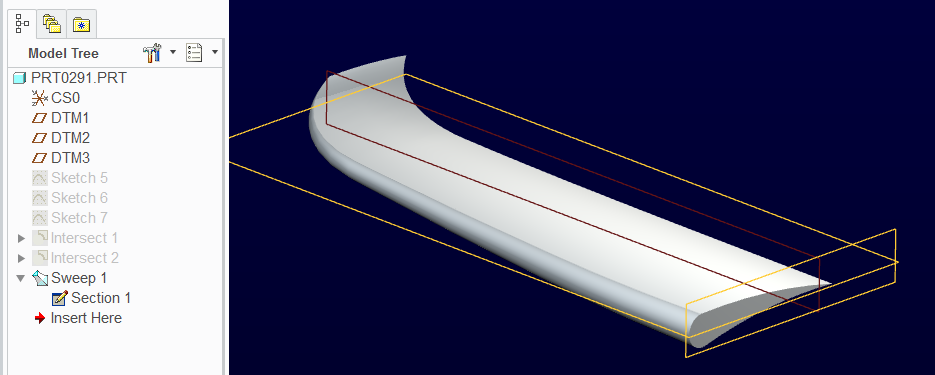

Hello, so I am trying to model a wing here but i am stuck with a problem.
I want the wing to curve at the end (like the picture at the bottom) but I just seems like I can't find any way to do it.
I've been trying everything (blend, swept, extrusion) but it doesn't work.
Does anyone know how to do this? Desperate need in help.
Best answer by TomD.inPDX
BTW: Welcome to the forum!
This is a variable section sweep using 2 intersects to add a twist.
Creo 2.0 file attached.

Typically a sweep/blend would do this but you could try the Warp feature.

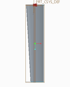

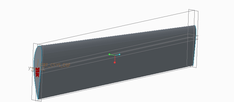

Any instructions for designing the wing? Thanks.
January 28, 2014
How to design a wing in general or how the one I posted was made?
January 28, 2014
How to develop a raked wing from the model I posted. I think the one you made.
