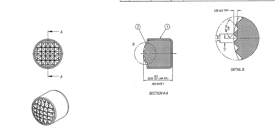

Please help me model the attached drawing. I am perplexed how to match the acorn appearance in the front view. My attemp to using Variable section sweep didnt give the results wanted
thanks

VSS is not your best method for that one. The "point" at the bottom of the inverted pyramid will be problematic with a VSS.
You are better off creating 3 element boundary surfaces for each pyramid. A bit more laborious to create the first time but really robust to changes later on.

I think that I would build the acorn by adding material via sweeping
triangle sections normal to the bottom face along curves that represent
the peaks of the acorn, each set swept at 90 degrees to the other.
The alternative is to build it up from edges - edges into surfaces -
surfaces into one big mesh and solidify the whole bunch of it. You'd
only need a quarter and then mirror twice.
