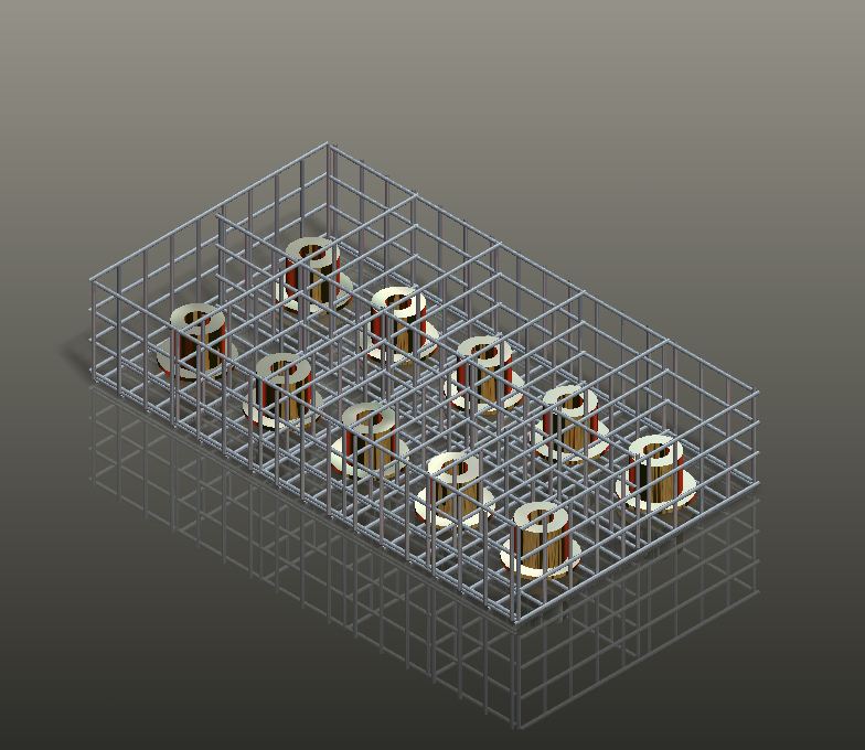

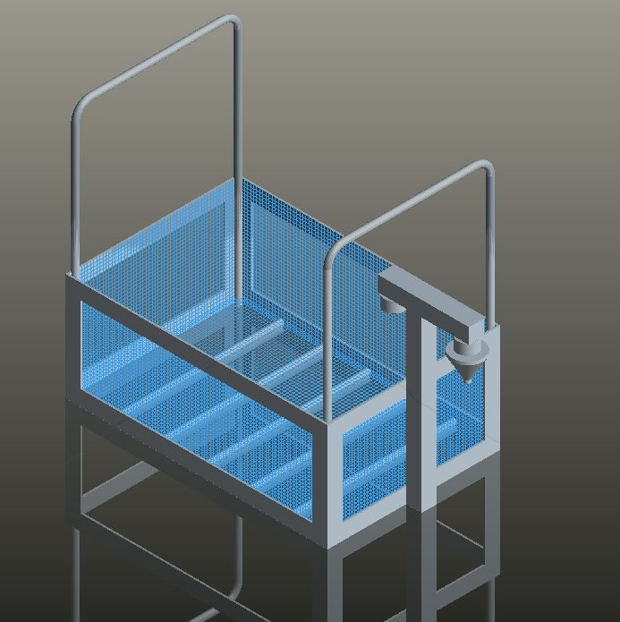

    Here are two ways I am currently doing this.... the first method is solid modelling it, which looks the best, its fine with 25mm Mesh, but on my current project of 5mm mesh, and much larger surfaces, it puts a lot of strain on my system.
    I am using cosmetic sketch on the 5mm one at the moment but as you can see it doesn't look as good...
    If you could post a screenshot of what you are able to achieve with other methods and some details on how you did it, that would be of great help!
    thank you very much
    Lee

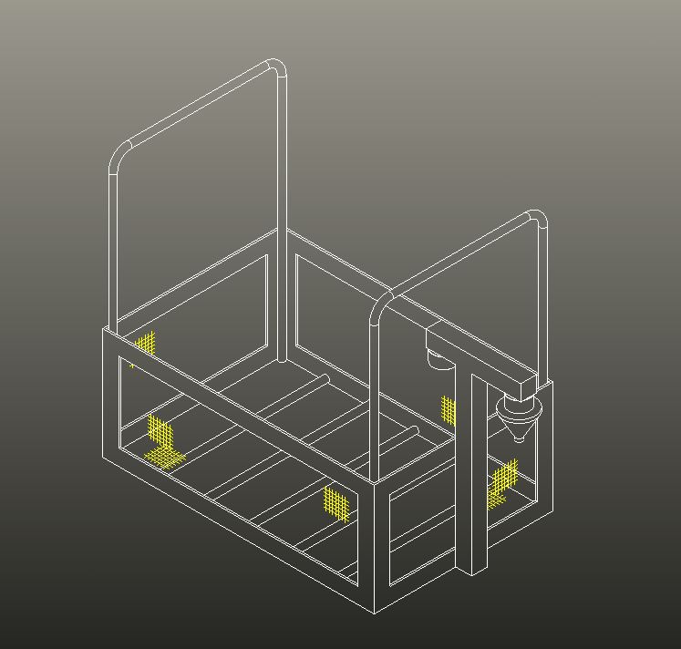

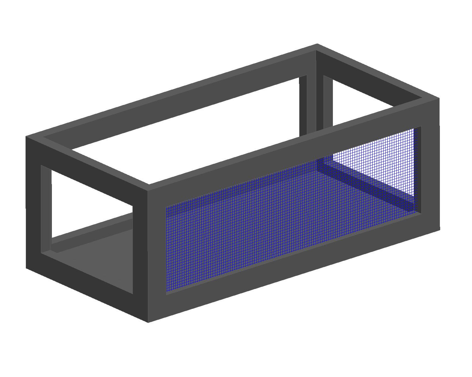

    July 14, 2010
    Lee,
    You can try the Surface vs. Solid option on your own; just choose that option in the Dashboard when making (or redefining) your features. I can't predict how much that will help, but sometimes there is a significant difference depending on the geometry. The decal suggestion is a little unorthodox, just something to consider. My recommendation, if you can live with the fact that the mass won't be properly represented, is to use Patterns of Datum Curves. In the illustration below there are two patterns of straight line curves, 113 in one, 33 in the other. Doesn't bog down the system at all.
    Good luck!
    David

    Thank you very much David, I've never used datum curves for such things before but as you can see this definitely gives the best results when performance is an issue!
