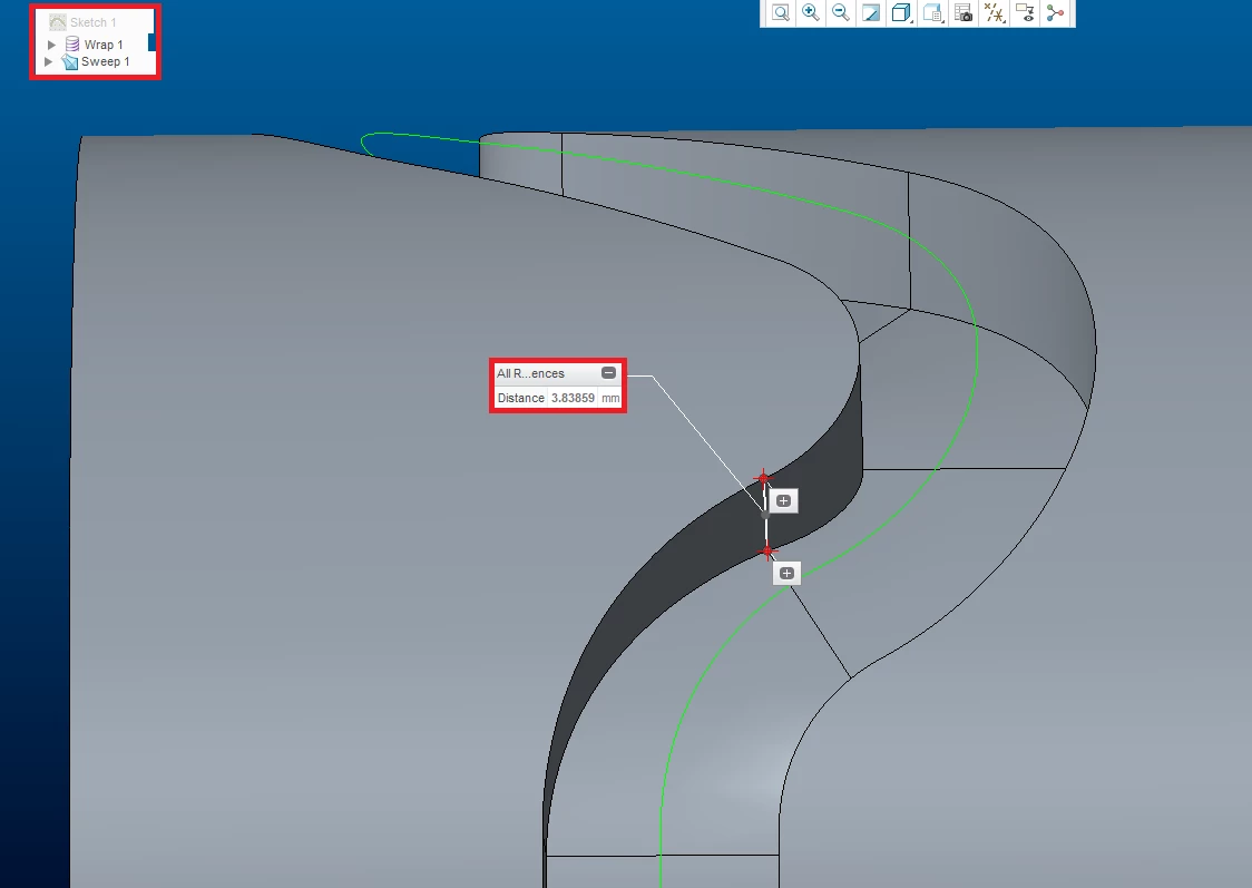

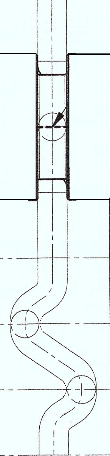

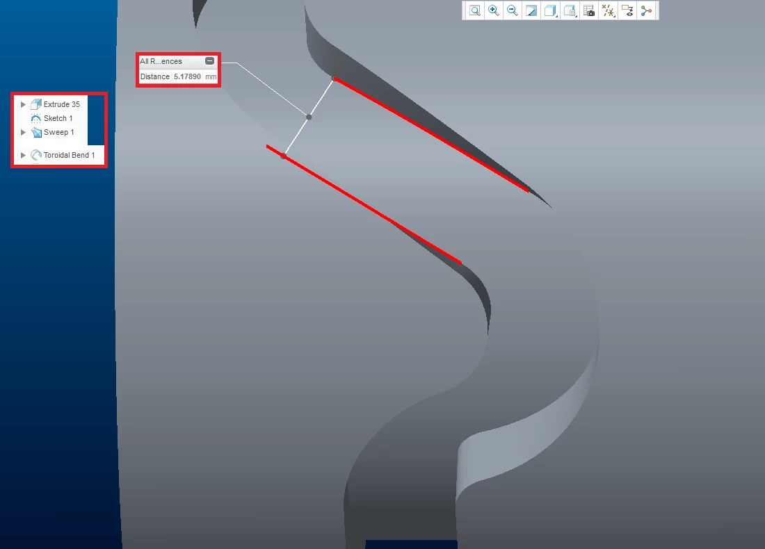

I have a problem with modeling a special key on a shaft. I need to create a key that has constant wide (6 mm) and constant deep (4 mm) everywhere on diameter. (attachment 3)
I tried two methods of modeling:
1) method - wide of the key is not constant (attachment 1)
2) method - deep of the key is not constant and radii are not tangent (attachment 2)

If I'm not mistaken, that specific application would require you to be able to sweep a 3d solid and that is not current functionality in Creo, although Creo 5 is supposed to have a 3d helical sweep.
There have been other posts about this:
https://community.ptc.com/t5/Creo-Modeling-Questions/Surface-generated-by-toolpath/m-p/47062
https://community.ptc.com/t5/Additional-Creo-Questions/Remove-interference-material-as-a-result-of-mechansim/m-p/71732
