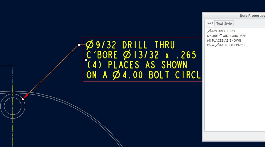

On the hole note, how do I find the feature numbers that were used?

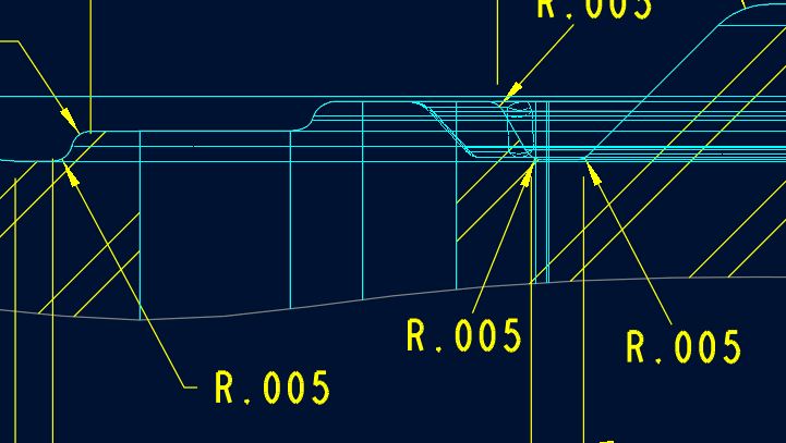

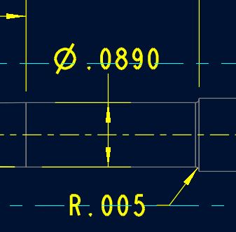

On the two pics below, how was the tail cut from the leader and the text reoriented?

Part 2 of your question is easy; use the shift key to move just the text.
...for the 1st Q, what happens when you switch text for symbols?

Per Antonius discussion for the 1st Q. The &d9, &d7, &d8 and &d10 probably are the text names for the dimensions for the various holes, diameters and circles in the model. While in the model and you right click to edit the feature, goto Info->Switch Dimensions and the dimension will change from their numeric value to their text value. This should show you the &d## for the dimensions. Hope this helps. Dale
