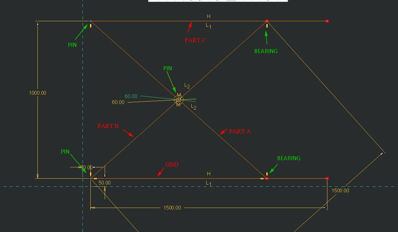

I want to use a motion skeleton in my design. I want to create mechanism like on the attached picture. I created body skeletons for all the bodies. GND, PART A, B, C. When I assign connection for body skeletons (In body definition dialog - not manually in component placement dialog) Creo doesn't recognise the mid pin. The two left PINs and Bearings are no problem but the center one. I tried to add circle to both PART A and PART B but unsuccessfull. I found in some training manual this:

The entity intersection doesn't works, or I don't understand the meaning of this. Is there something else that it is need to take into acount when creating sketch (e.g.the order of creating sketch entities?). Could please someone explain the logic how creo look for connections between bodies?

Hi Michal...
The circle thing they show in the training guide is, in my experience, useless. You don't need all those circles to communicate you want a "pin" constraint. It's all about those rules you posted - these are the golden rules:
  • Pin joints can be defined at entity intersections or at circle centers.
  • Slider joints can be defined from overlapping lines.
  • Bearing joints can be defined where a line meets a non-endpoint location of another line.
  • A Slot connection can be defined where a line endpoint lies on an arc or circle.
  • Ball and Cylinder joints can be selected at locations where a Pin joint is found.
Here are some things to check:
  • Try eliminating the circle
  • Try selecting the circle and making sure the center point lies on both the line "A" and "B". right now I don't see a constraint attaching it to "A". It's just sitting at the center point of "B".
  • The line representing part "A" and "B" should not be split at the center point. The lines should just cross.
  • Check to see if "Pin" is available as a drop-down choice when the connection is being made
    • If it is NOT, see what IS available. This will provide a clue to how the sketch is being interpreted.
You're close - something simple is probably all you need to fix this thing! See if any of those comments above help out.
Thanks!
-Brian
swuest1-VisitorAnswer
February 24, 2017
I don't know if it's the best way but you can divide the bodies A and B in 4 different segments.
And when you will add the body B you will see the pin connection.
Check if it's normal there is more than one pin connection.
In any case it's works fine (see video)
Video Link : 7621
Stéphane
February 27, 2017
Of course this would work - but I regarded it as a change to the intent of the original author's model.
8-Gravel
February 27, 2017
thanks for the responses.
The Stephane's solution works fine for me. I couldn't do it work without splitting the lines.

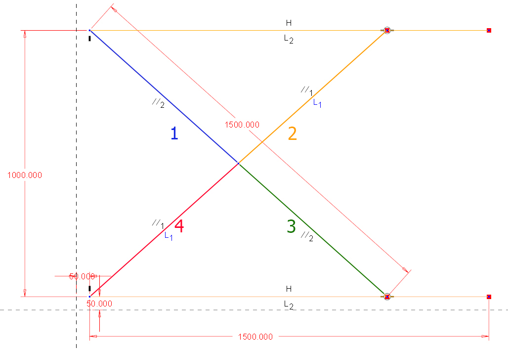

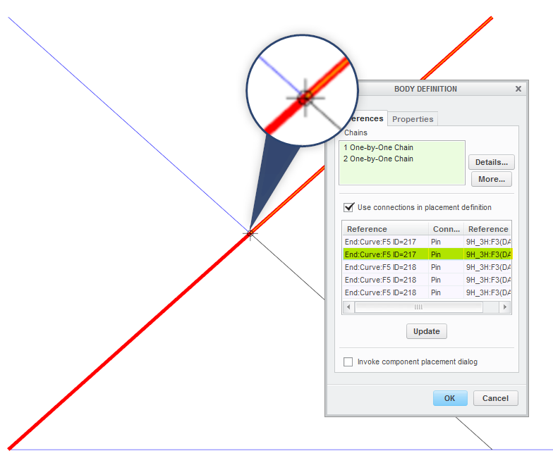

Ok, I stumbled on a problem: I created a body skeleton for one of the scissor-arms (as one line).  Using the "update" button only brings up two bearing joints.
So, I changed the layout sketch and made split this line into two so that I can get at the middle pin joint.

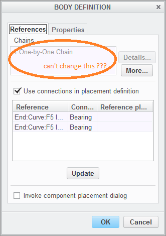

Now I want to re-define this body skeleton, but I get this grayed-out list:
The only way to proceed is to delete this skeleton part and start over from scratch?
Am I dumb and missing something, or this is how it is supposed to work (in that case, that's dumb...)

Hi Paul...
I have NOT checked - but I seem to recall you get like, "one golden shot" to get it right and then you're stuck with the chain reference. When I had this same issue, I had to redo the body definition. I may have just been hacking through it and not paying attention but I know this happened a few weeks ago. It was early in my body definition so I didn't think much about it.
Maybe try right-clicking the feature in the model tree to see if "Edit References" is available? Let us know what you find.
Thanks!
-Brian
March 3, 2017
Yeah, I gave up on this.  It seems like a legacy feature from the days before.  Do people still really do this - use these 2D sketch-driven mechanism skeletons?
If you know PTC's esoteric rules (which don't seem to work anymore - crossing the lines will not result in a pin joint!), you get to take a shortcut and some datums are automatically prepared for you.  But if you change your mind, you go back to the real solution - so do some work up-front and prepare body skeletons with motion axes and planes and then assemble these body skeletons together using the mechanism constraints.
