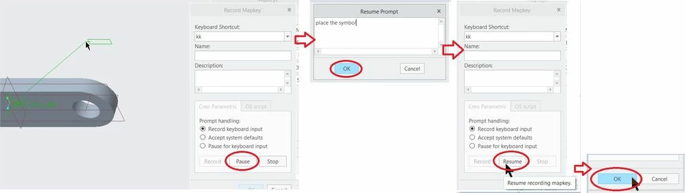

August 19, 2018
hi DTC60,
You could add a 'pause' in the mapkey when you are recording it. In this pause you will clic the mouse middle button twice, then resume the mapkey to be able to select "OK" in the dialog box, and finish the recording.
Every time you run the mapkey you have to click the mouse middle button twice 'manually' and then click resume, but the job will be done.
DCT601-VisitorAuthor
August 20, 2018
Thanks for your answer but I know this process by heart !
What I try to find is an alternate solution to avoid the "pause" in mapkeys what is deadly boring!!
August 20, 2018
DCT60,
You can use an AutoIT script [https://www.autoitscript.com/site/autoit/] to send the mouse clicks to Creo Parametric.
Dan N.
