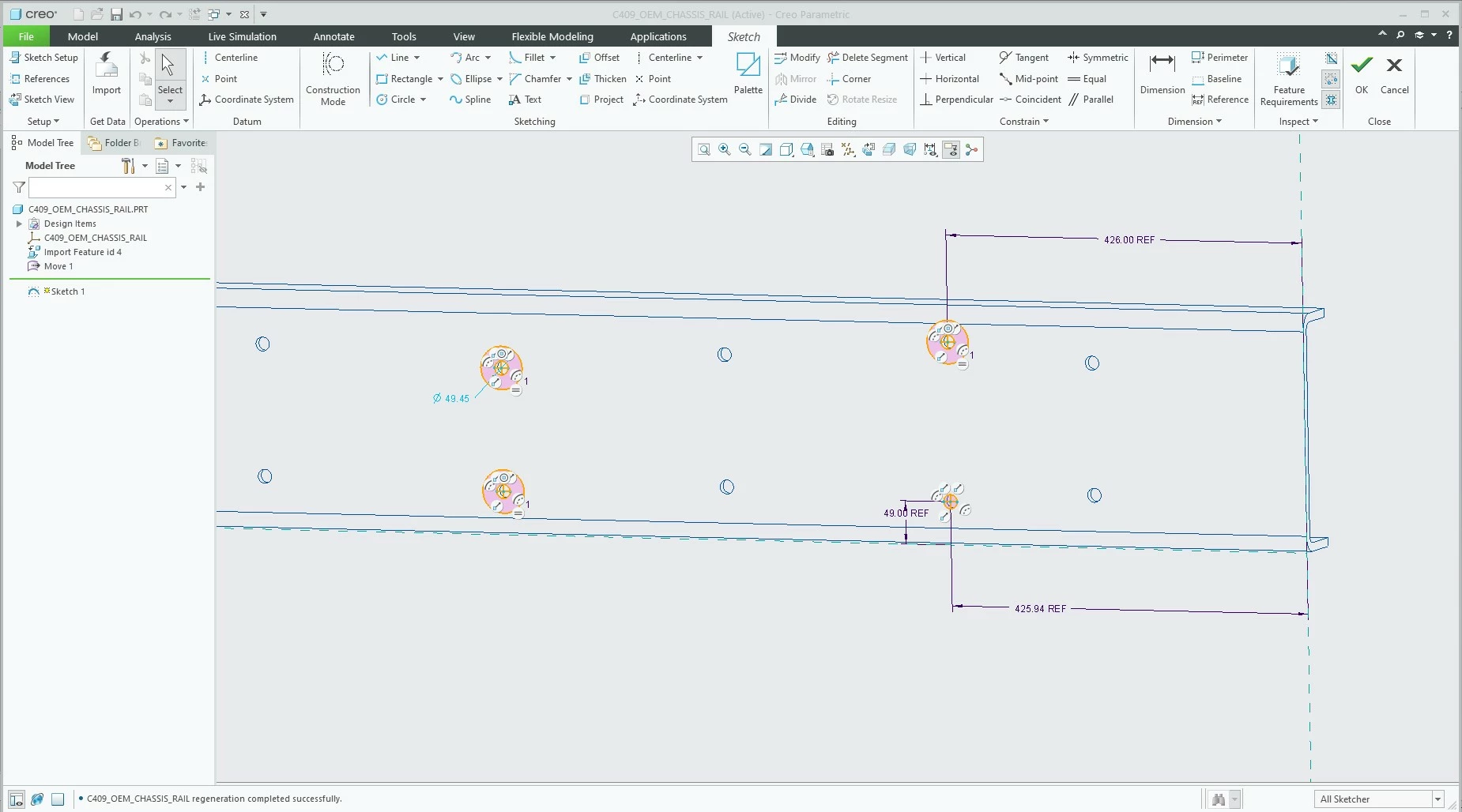

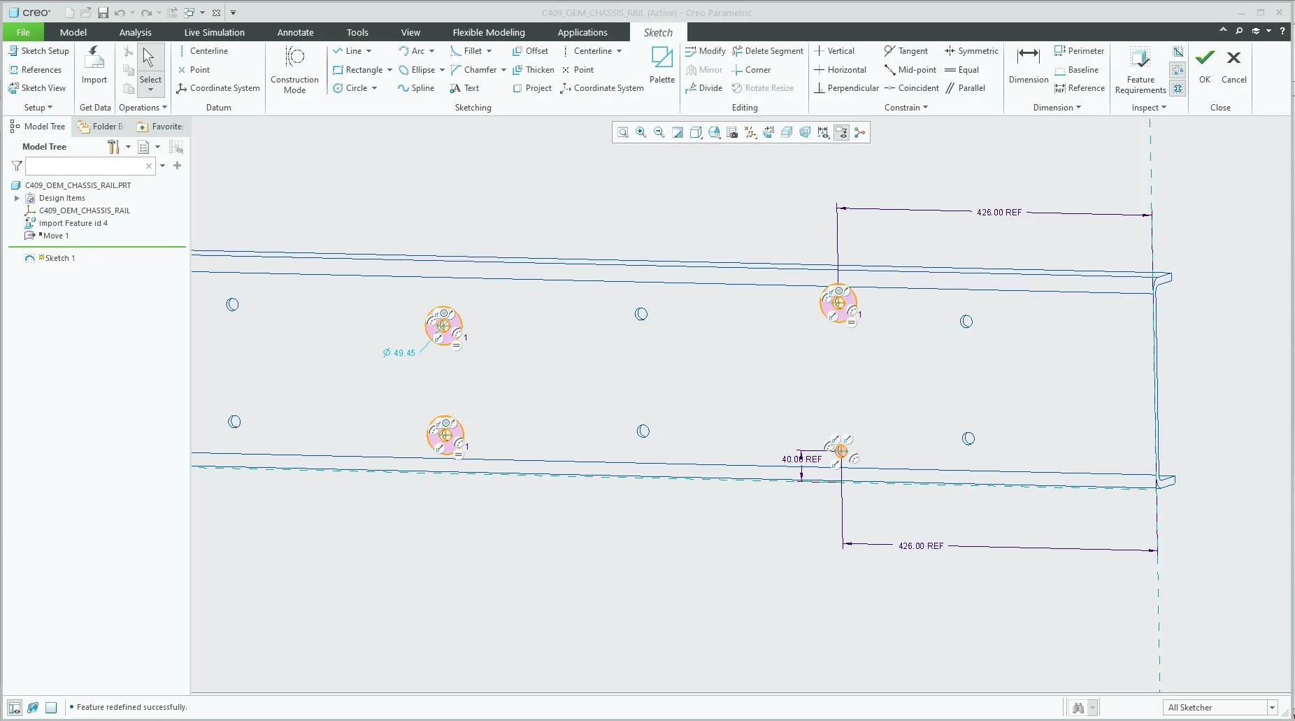

Using Move By Dimension in Flexible Modelling to adjust in Y direction causes dimension value changes in X direction in Creo Parametric.
There's a bug in the move function.
if you look at the sketch it shows one hole that is moved by the 'move' in the tree above.
The move is dimension driven and moves the hole from 40 to 49mm away from the bottom face.
The feature also moves the hole a tiny distance parallel with the face, which it should not.
You can see this by opening the sketch with the move suppressed and again with the move active, as shown in the two jpegs.

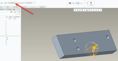

Just guessing, make sure that your geometry is "square" to the coordinate system or move direction reference.  At least once, I have seen geometry that was imperceptibly skewed from the datums.

You may want to use the origin and/or orientation to select reference the move referenced. May need to specify the bottoms and the end to reference.

See related article CS385938 "Using Move By Dimension on a cylindrical surface in Flexible Modeling causes the surface to move perpendicular to the dimension in Creo Parametric". The related SPR is still under investigation. So please keep track for any updates. See CS235695 How to subscribe to articles for PTC Products.
