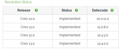

Jan 20, 2026 1:26 PM UTC
PTC has replied that a resolution will be released in future versions.
