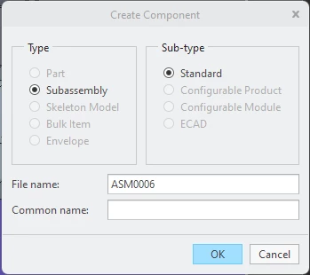

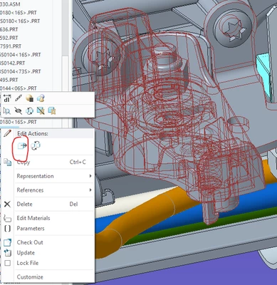

kdirth
Mar 9, 2023 1:14 PM UTC
There is a command that may be useful.  Ensure all of the parts are structured as a sub-assembly in the model and are consecutive in the tree.  Select all of the parts, RMB, select the Move to New Sub-assembly button (this command is not found in the ribbon out-of-the-box), and complete the Create Component dialog box.
