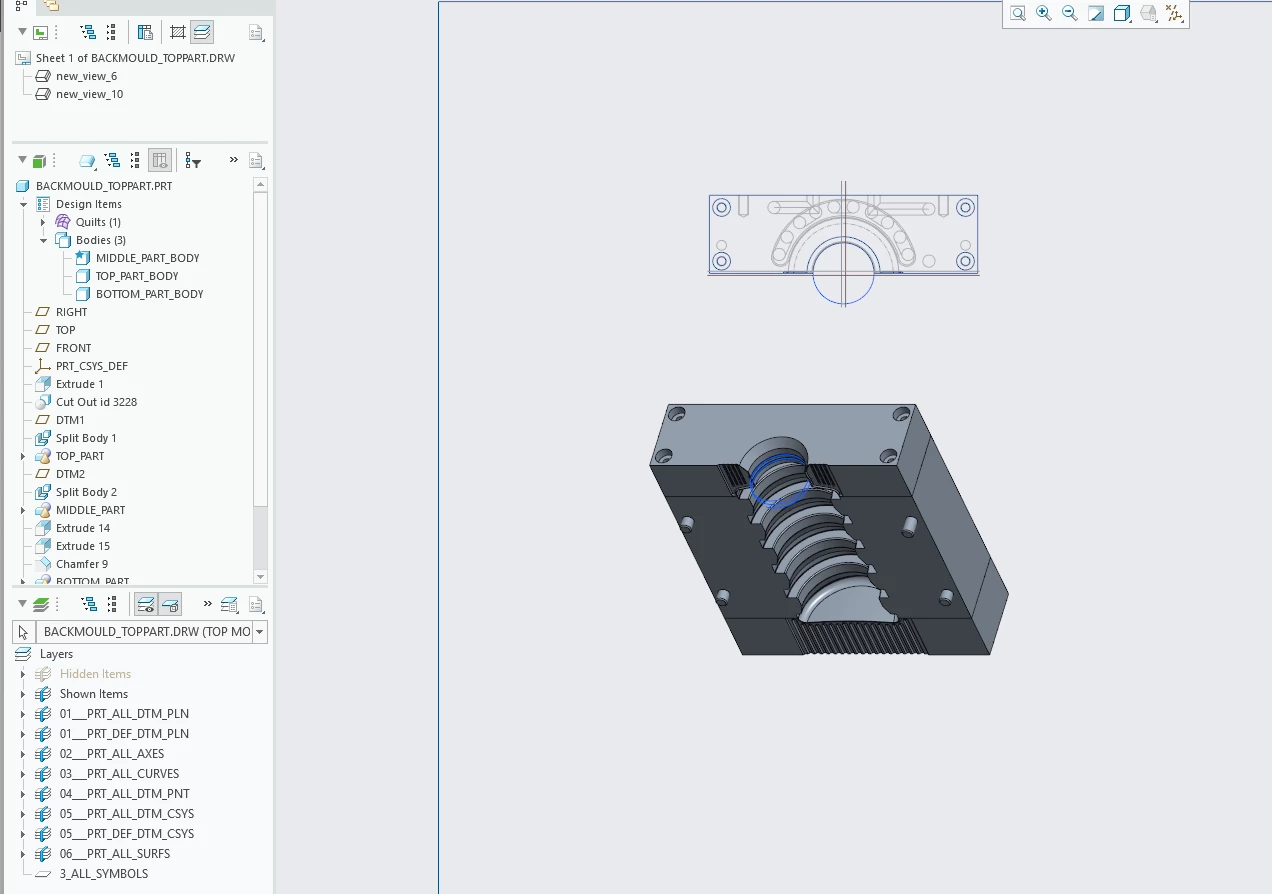

I have a Mould that has 3 Bodies
When I make a drawing I want to show only one of each bodies.
My goal is
in the 1st sheet I will show the views of  top part of the mould
in the 2nd sheet I will show the views of middle part of the mould
in the 3rd sheet I will show the views bottom part of the mould
and in the 4th sheet I will show 1 view top part and another view middle part and so on..
each sheet will have top view, bottom view and side views of the body
Please let me know how I can do it

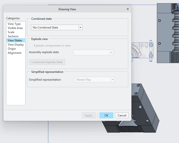

Yes you can do this, but do not try to hide/show bodies manually on each drawing sheet. The better workflow is to create body specific display states as simplified representations in the part, then assign the correct state to each drawing view.
Michael Bourque
7-Bedrock
Jun 23, 2026 1:16 PM UTC
But I’m not able to change the simplified representation.
How do I activate it?
Michael_Bourque
Jun 23, 2026 1:34 PM UTC
Create a combination state that represents each body and rep so that it hides the other bodies. Then when you create a sheet, choose the drawing models ui to select that combine state. Then you can edit the view and choose which combination state would be shown. Which version of Creo are you on and maybe I can send you an example. I tested this in Creo 13.
Michael Bourque
7-Bedrock
Jun 23, 2026 2:22 PM UTC
I’m using creo 11.0.1.0 academic edition
Will try doing it again.
And yes, an example would be helpful

The most promising is to use Combined States. This is best done from the View manager. As a subset of your combined state, you can define Layer States to hide/show bodies. From the Model tree, under Design Items/Bodies, simply hide/show the bodies you want and save the changes to the Layer state. Then use that layer state specifically in your Combined State.
Then in the drawing, you can have each drawing view based on the combined state or view state. This looks great on the drawing, but you are out of luck if you ever want to print it. If you save as a PDF, all the bodies will be shown. This is probably due to how layers in models are NOT the same as layers in drawings.
