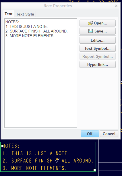

Indeed, the default is to put up a one-line-at-a-time field to create a note. However, you can edit this note in the editor by selecting the note's properties.
If I need to type or paste significant text into a note, I often just place an "xx" on the drawing and then edit the note properties after the fact. Now I can cut and paste and edit to my heart's content.
An idea to provide a note option to making a one line note or open the text editor directly would be nice. Maybe it is even possible, but I certainly don't know how one might access it. Problem is, this XTOP dialog is as old as Pro|E and these menus simply don't get a lot of attention.

Aha... yes, you do have the option to place a note that is saved as a file

You can just type in the text entry for note creation. The Note will end if you use Enter on a blank line, so if the line has no printing characters, use a space. The text entry also doesn's accept Paste of multiple lines.
If you want to edit the note, the Properties selection will get you what you want, though if you are using a fixed-width font, Notepad or some other plain text editor will be less painful to get columns of letters to line up.

True, you can initiate notepad fom the multiline properties editor.
