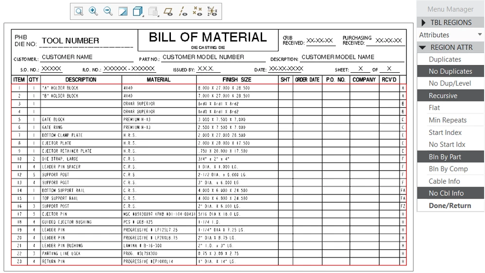

To see if there are any repeat region relations, do this:
Click on the Table tab with the drawing sheet that has your BOM on it
Select Repeat region from the task bar
When the Menu Manager opens, select Relations and then click in your BOM table
This will open the Relation editor and show any existing relations for that repeat region.
Post your relations, if there are any.

If you are using a repeat region in a drawing table, try setting the table region attributes to No Duplicates.

If I do that a few things happen:
1) The number of entries goes from 58 to 53 - so more than just this part get's renewed / erased.
2) Instead of now those two entries (one with 16 pcs, the other one with 8 pcs) appearing, just the 16 pieces entry is appearing.

Weights are only relevant if have assembly level modifications, such as flexible components (like springs and show in the model tree as in image below) or assembly cuts/holes that change a part at the assembly (2 washers in an assembly but one of them is cut so the weight of one of the washers is different than the other).
Do you have any assembly cuts in your model?
No repeat region relations makes it easier, means not custom modifications to your bom.
Have you tried adding another table on your drawing to see if it matches and to compare with your current BOM?
No duplicates (or no duplicates/level) in the table attributes fixed the problem but what other parts changed in the BOM? Were there other duplicates that you hadn't noticed?
